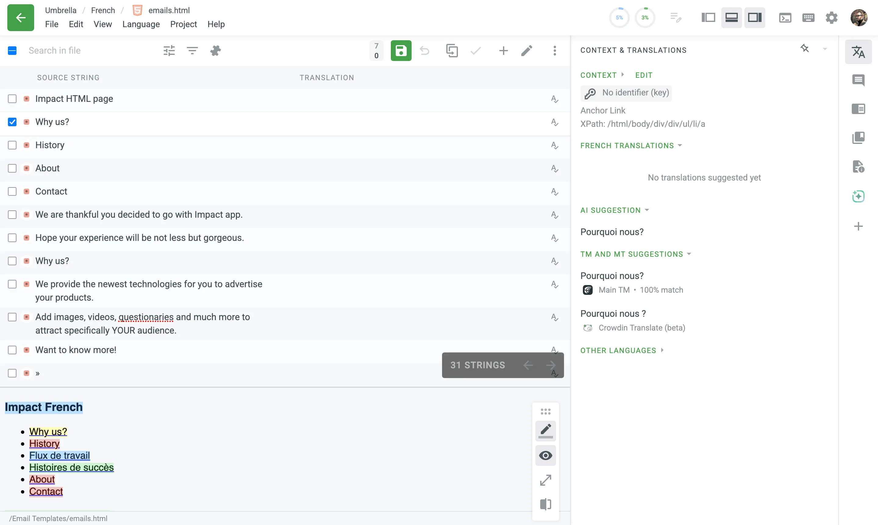

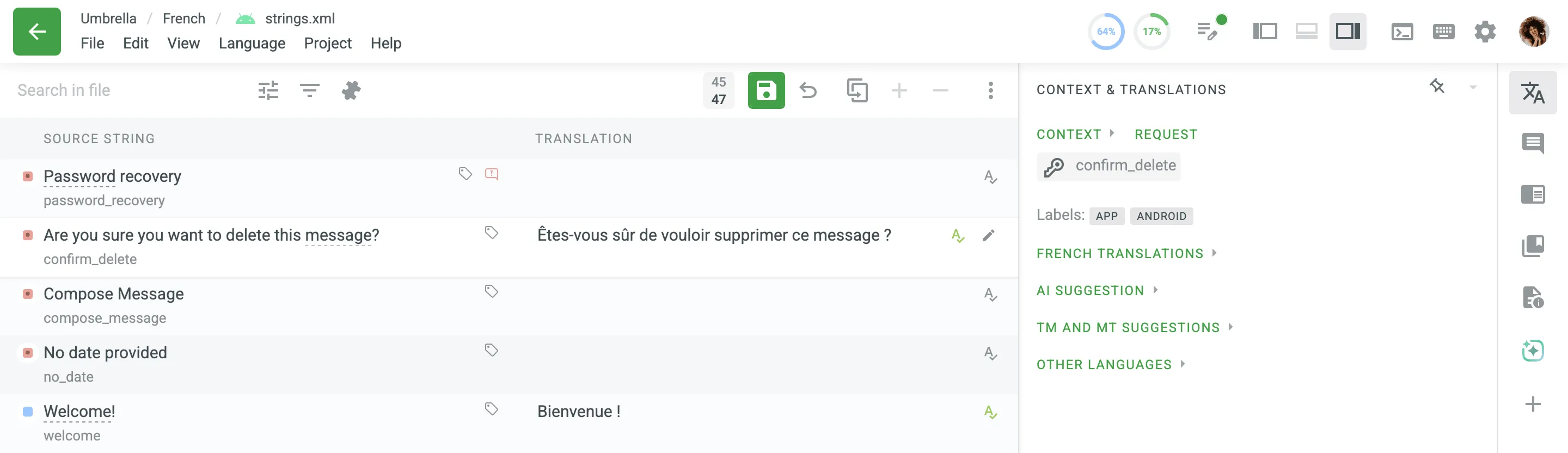

Side-by-side Editor mode

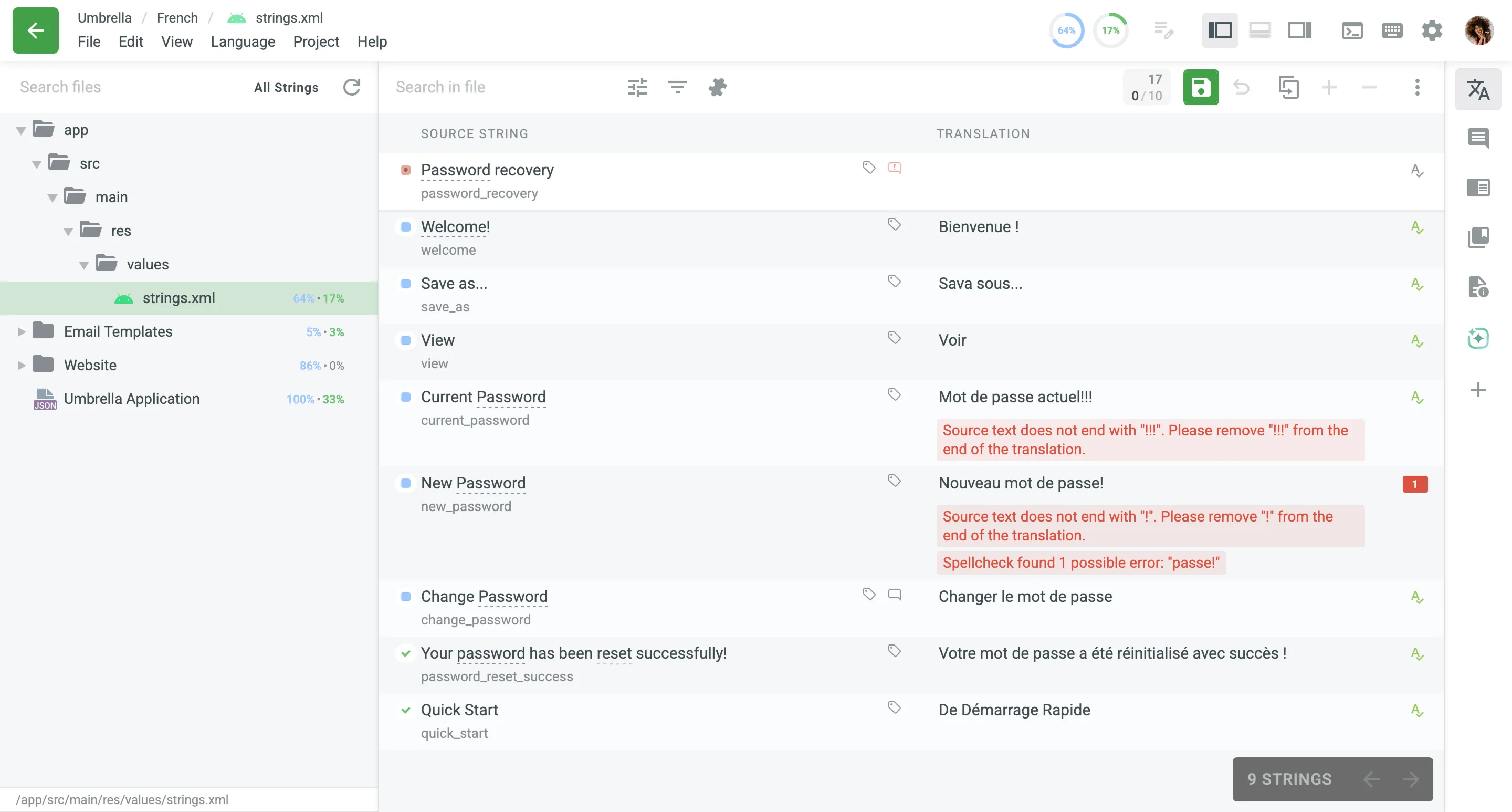

This section displays the list of strings, with the active one highlighted. Strings are text elements that are either individual words, phrases, or sentences. Some strings might have replacement tokens (e.g., 0, 1, %1, etc.) or elements of the ICU message syntax. Such items themselves should not be translated but are used by the website code to dynamically insert some information into strings. To work with such strings, you should copy the source string and translate only the real words.
Strings can have the following statuses:
  • - untranslated
  • - translated
  • - approved
There also might be the following icons besides strings:
  • - the string has comments from contributors
  • - the string has an unresolved issue
  • - the string has labels
To suggest a translation, select a string from the list and enter your suggestion in the field next to the original text. When you’re done, click Save translation. Your suggestion will be added to the string’s translation suggestions list, and you’ll automatically move on to the next string. If you need to discard your current input and revert to the previous state, click Cancel.

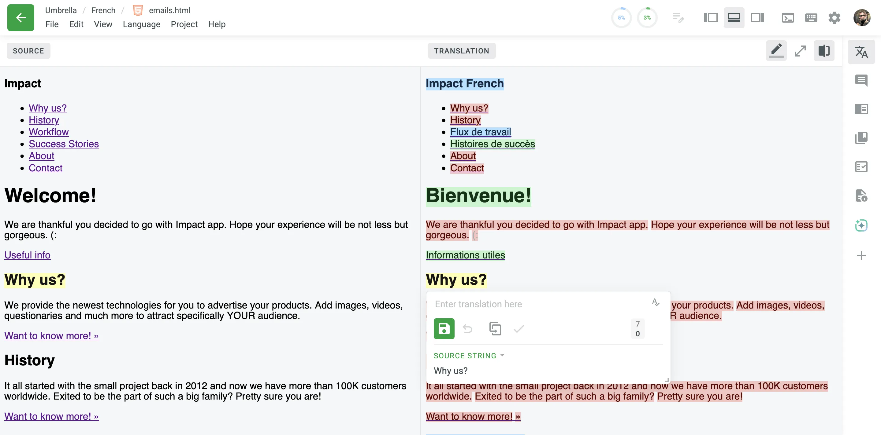

HTML view
The following options are available to manage the above view:
  • - Highlight untranslated, translated, and approved strings. Use it to toggle the color highlighting of strings on and off.
  • - Show translation preview. Use it to toggle the translation preview mode on and off.
  • - Full Screen (by default, Ctrl +F or +F ). Use it to expand the preview to the full screen.
  • - Dual Preview (by default, Ctrl +D or +D ). Use it to display the Source and Translation files side-by-side.
When you switch to Full Screen or Dual Preview, the preview displays the entire file, bypassing the pagination limits of the standard string list.
Instead of using the side panel, you can translate contextually using inline editing:
  1. Click on any highlighted text directly within the WYSIWYG preview.
  2. A popover will appear where you can enter and save your translation.
  3. If you need to reference the original text while translating, click Source String within the popover to expand it.
In Dual Preview mode, clicking a string in the Source panel will automatically highlight the corresponding string in the Translation panel (and vice versa) while opening the translation popover.
Inline Editing Popover

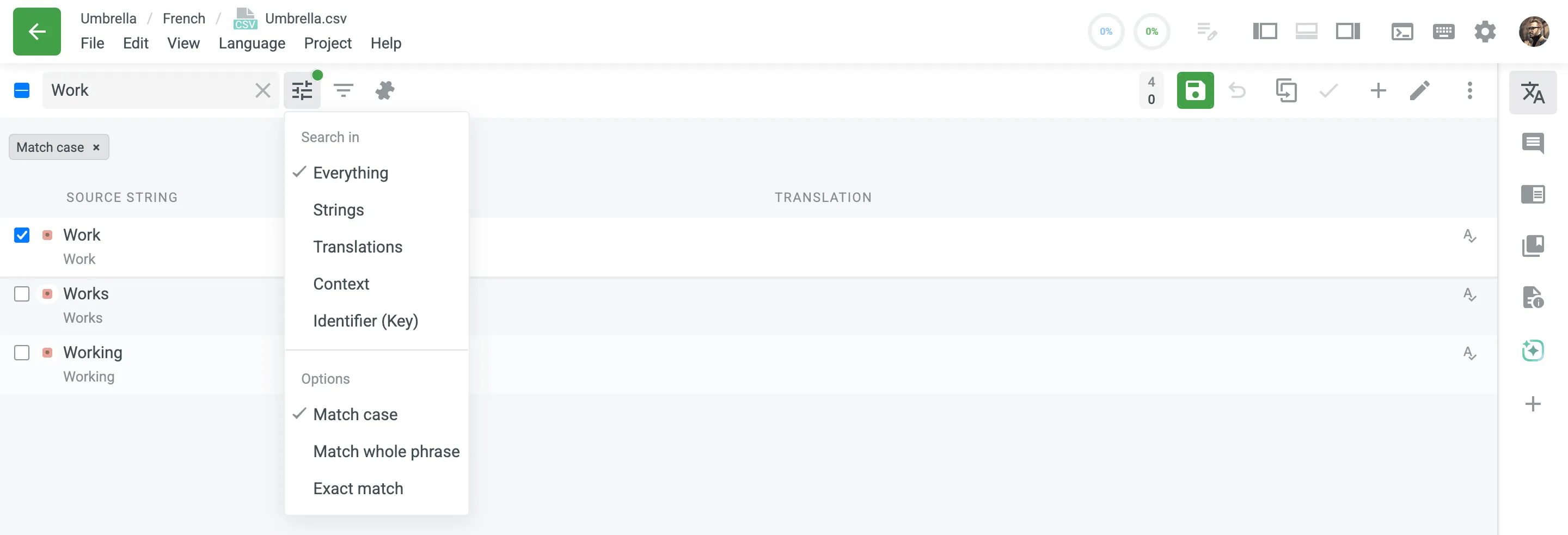

To find specific strings in the Editor, type your query into the search field at the top of the string list. Use the keyboard shortcut (by default, Ctrl +F or +F ) to instantly focus on the search field.
String Search
  • Translations – search through translations only.
You can combine Match case with either Match whole phrase or Exact match. Note that Match whole phrase and Exact match are mutually exclusive.
The search phrase is limited to 128 characters. If you use a search phrase longer than 128 characters, it will be automatically truncated to the maximum allowed length.
You can also find a specific string by its internal numeric identifier (a number automatically assigned by Crowdin). To do so, type the numeric ID (e.g., 34354) into the search field without quotation marks to get an exact match. To search for the occurrences of the number in the text or context, enclose it in quotation marks (e.g., "34354").

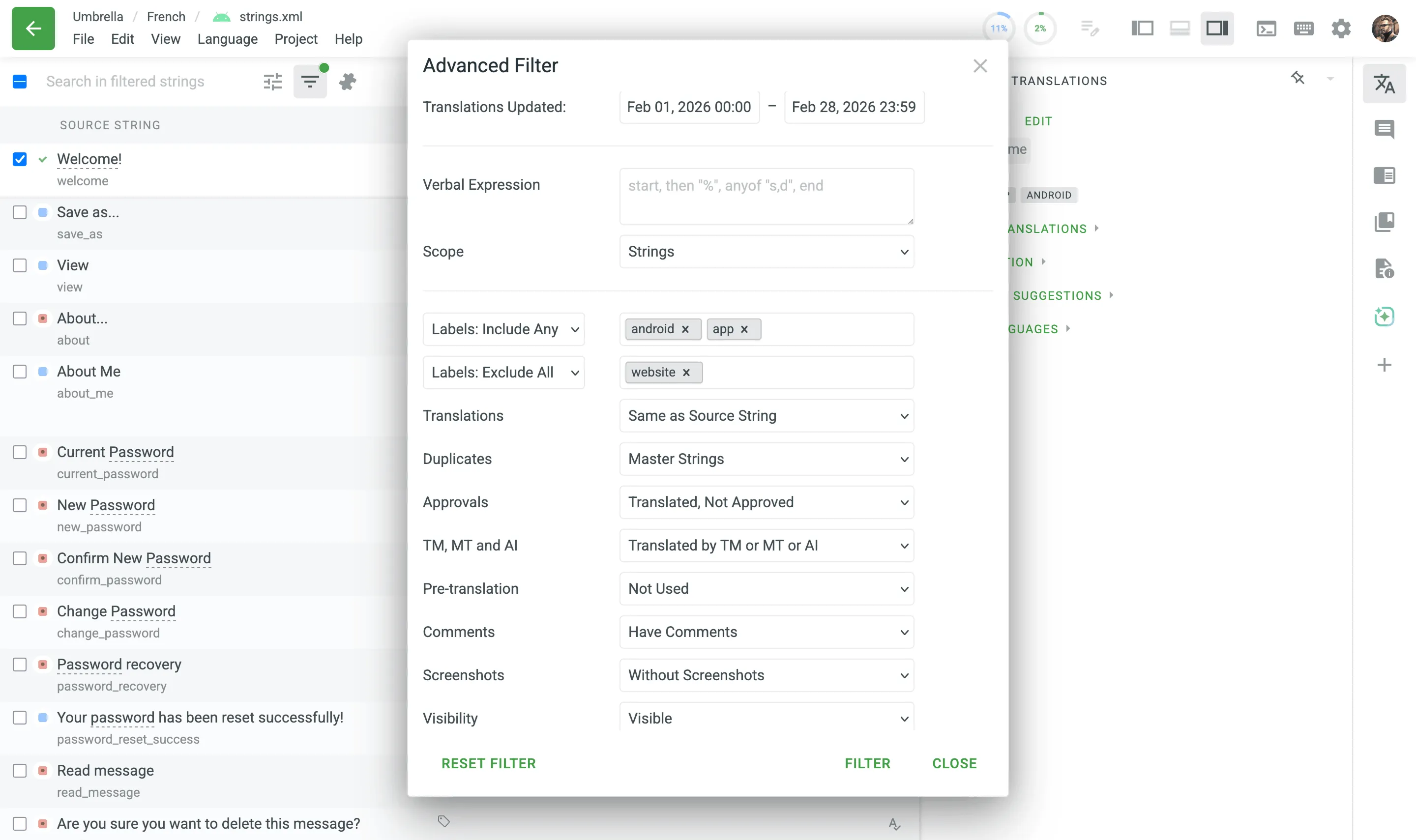

Available filter options:
  • All, Untranslated First – Show all strings from the opened file/folder. Untranslated strings are displayed at the top of the list, followed by translated strings, and then approved ones are displayed at the bottom of the list.
  • Unsaved Translations – Show strings with translations you entered but haven’t saved yet.
  • QA issues – Show strings with or without unresolved QA issues in the current language, with the possibility to filter by specific errors.
  • Machine Translations – Show strings that are translated by TM, MT, or AI suggestions without changes. Often these strings require additional review.
  • Hidden – Show strings that are hidden from translators. Strings can be hidden by project managers or automatically hidden by Crowdin when they are marked as duplicates.
Strings Filter

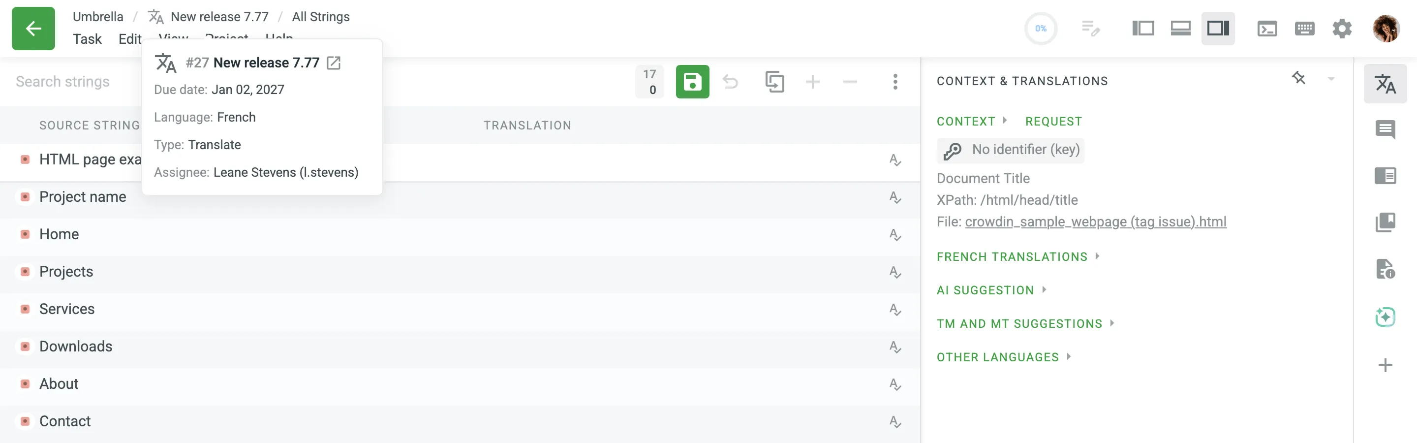

When translating, understanding the surrounding text can be crucial for accuracy. The Editor allows you to display the strings that immediately precede and follow your active strings in the source file, even if they don’t match your current filter criteria.
To toggle this context view on or off, click the Show surrounding strings for context icon next to the search field, or select this option from the String menu. When enabled, the Editor will load and display up to five preceding and five succeeding strings for all strings currently displayed on the page.
Context strings are visually marked with a puzzle icon and appear greyed out to distinguish them from the strings in your primary filtered view. How you can interact with them depends on how you accessed the Editor:
  • Normal Editor Mode: When you open a source file directly in the Editor, you can interact with context strings just like regular strings. Despite being greyed out, you can still select them, add translations, vote on them, and approve them.
  • Task Mode: When you open a specific task in the Editor, context strings are provided purely for reference. They are strictly read-only, meaning their input fields and action buttons are disabled. This ensures you have the necessary context without accidentally modifying strings outside your assigned task scope.

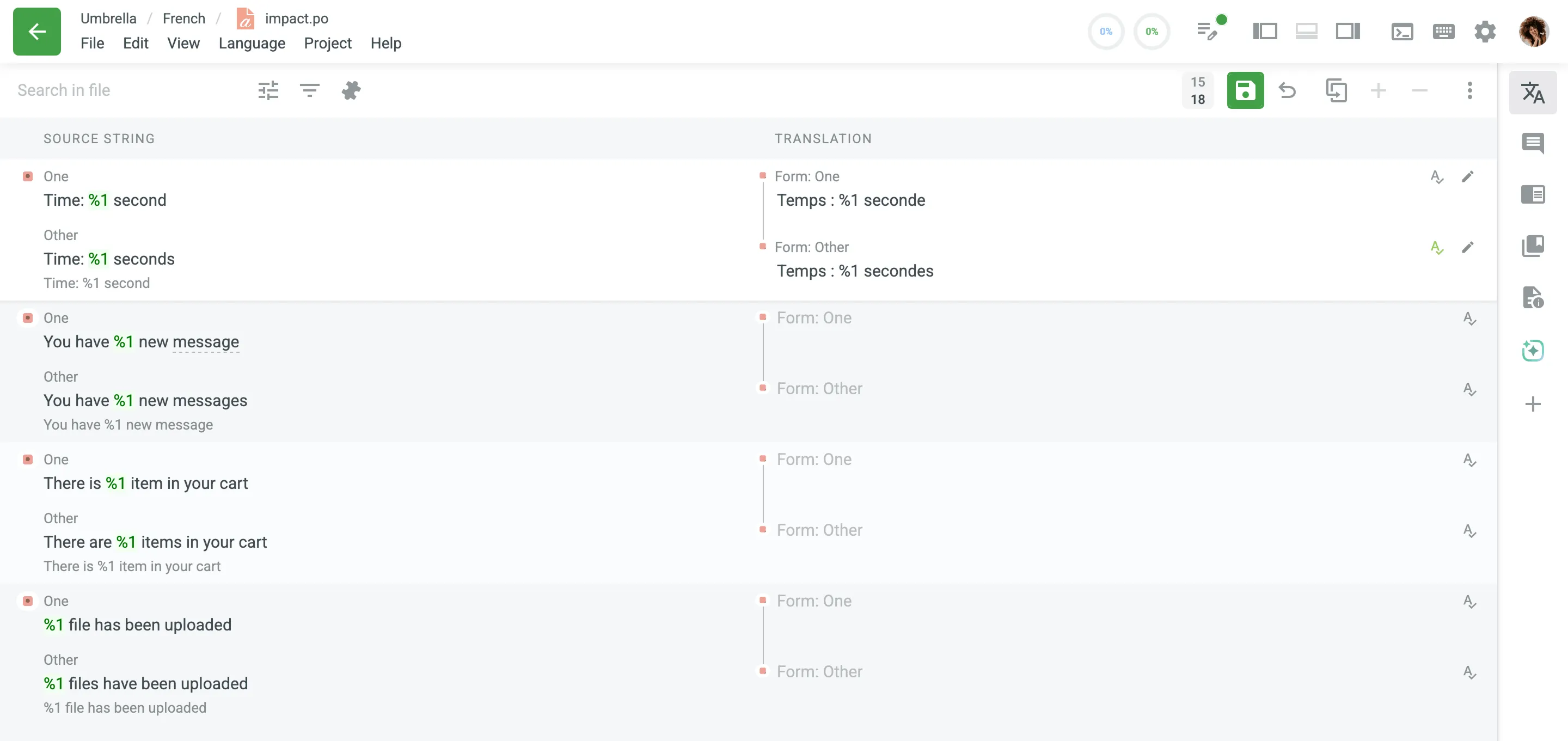

Some strings may have plural forms. Depending on the language, the number of plural forms may vary. For example, Chinese has one plural form, English has two plural forms, and other languages may have up to six plural forms. Crowdin works with plural forms according to the CLDR Language Plural Rules.
Read more about CLDR Language Plural Rules.
If a string has multiple plural forms, all variants of the string are displayed in the section where you type in translations. Enter translations in the appropriate sections that display the plural forms of the target language.
Plural forms

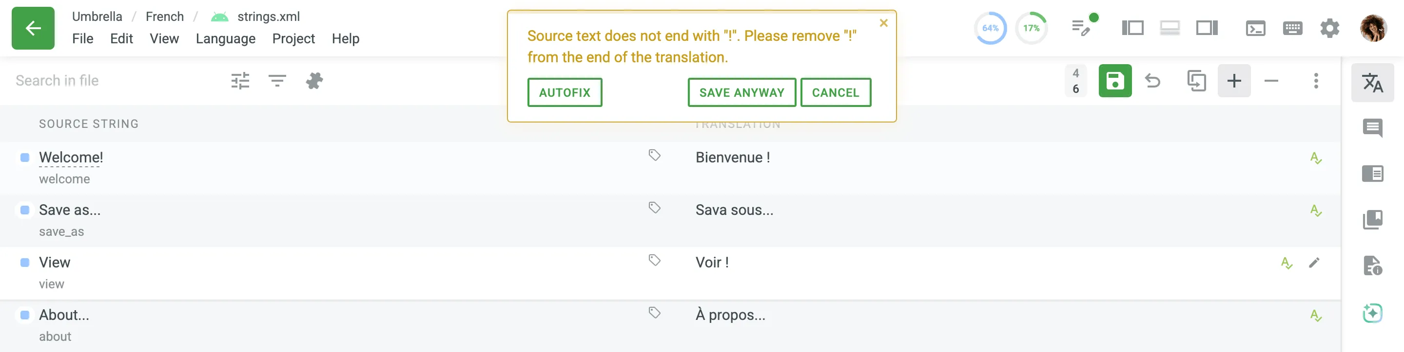

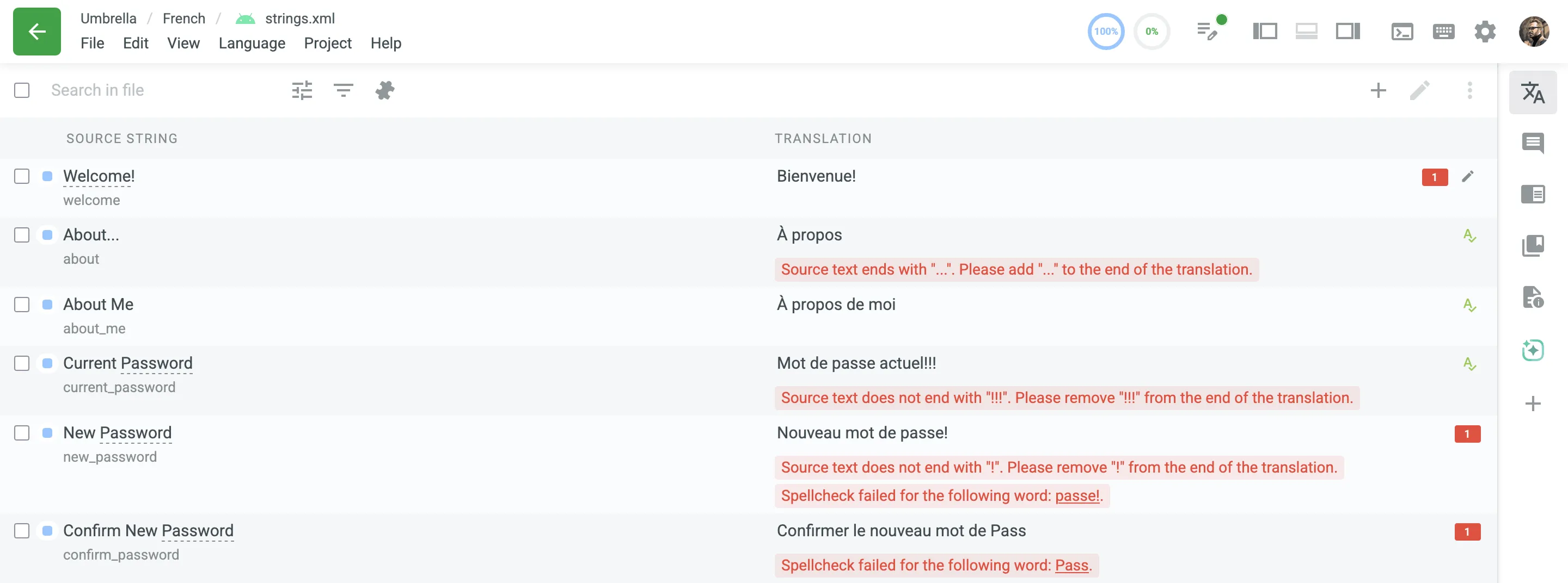

You might also get automatic Quality Assurance (QA) check pop-up messages to avoid some translation inaccuracy. For example, you can see notifications about inconsistency in punctuation, space mismatch, missing variables, and more.
QA pop-up

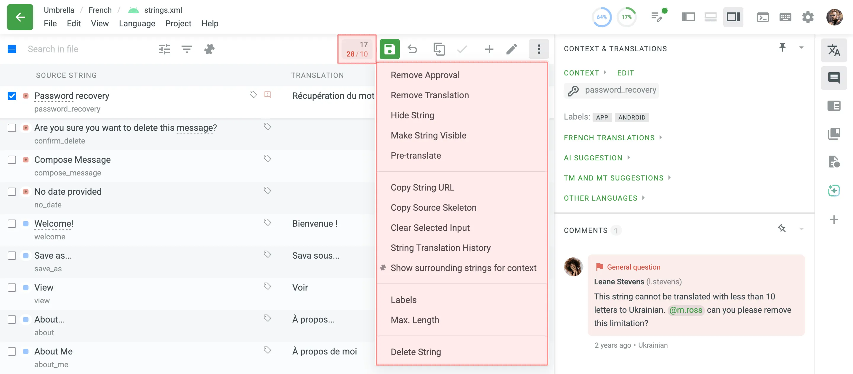

Clicking in the upper-right allows you to:
  • Remove Approval – Remove the approval for a translation, reverting its status to unapproved. (Available for proofreaders or higher.)
  • Remove Translation – Clear translations for the selected strings along with the associated TM records. Duplicate translations from master strings remain unaffected.
  • Hide String / Make String Visible – Toggle the visibility of a string for translators. Hidden strings are accessible only to project managers or higher.
  • Pre-translate – Initiate pre-translation directly in the Editor using Translation Memory (TM), Machine Translation (MT), or AI.
  • Copy String URL – Access a specific string using its unique link or share it with colleagues.
  • Copy Source Skeleton – Copy untranslatable elements to the translation section. This action can be applied to one or multiple selected strings. Useful when translating strings with ICU message syntax or HTML tags.
  • Clear Selected Input – Clear the translation field for the selected string.
  • Translation History – View all the modifications made to the string.
  • Show / Hide surrounding strings for context – Display up to five preceding and five succeeding strings for all strings currently loaded in the Editor to help you understand their context. This performs the exact same action as the button in the main toolbar.
  • Labels – Add or manage labels assigned to the string, helping to categorize or identify it for specific purposes.
  • Max. Length – View and edit the maximum character length allowed for the string translation. Clicking this option opens a modal with the following settings:
    • Proportional to source texts – Set the maximum length as a percentage of the source text length. Use the slider or manually enter a percentage (e.g., 100%, 150%, 200%) to define the limit.
    • Fixed max. length – Specify an absolute character limit for the string translation.
    • Unlimited – Allow translations of any length without restrictions.
  • Delete String – Permanently remove the string from the project. (Available to project members with manager permissions or higher.)
In the translation window, you will also see the Maximum length of translation limit if it’s exceeded.
String Menu

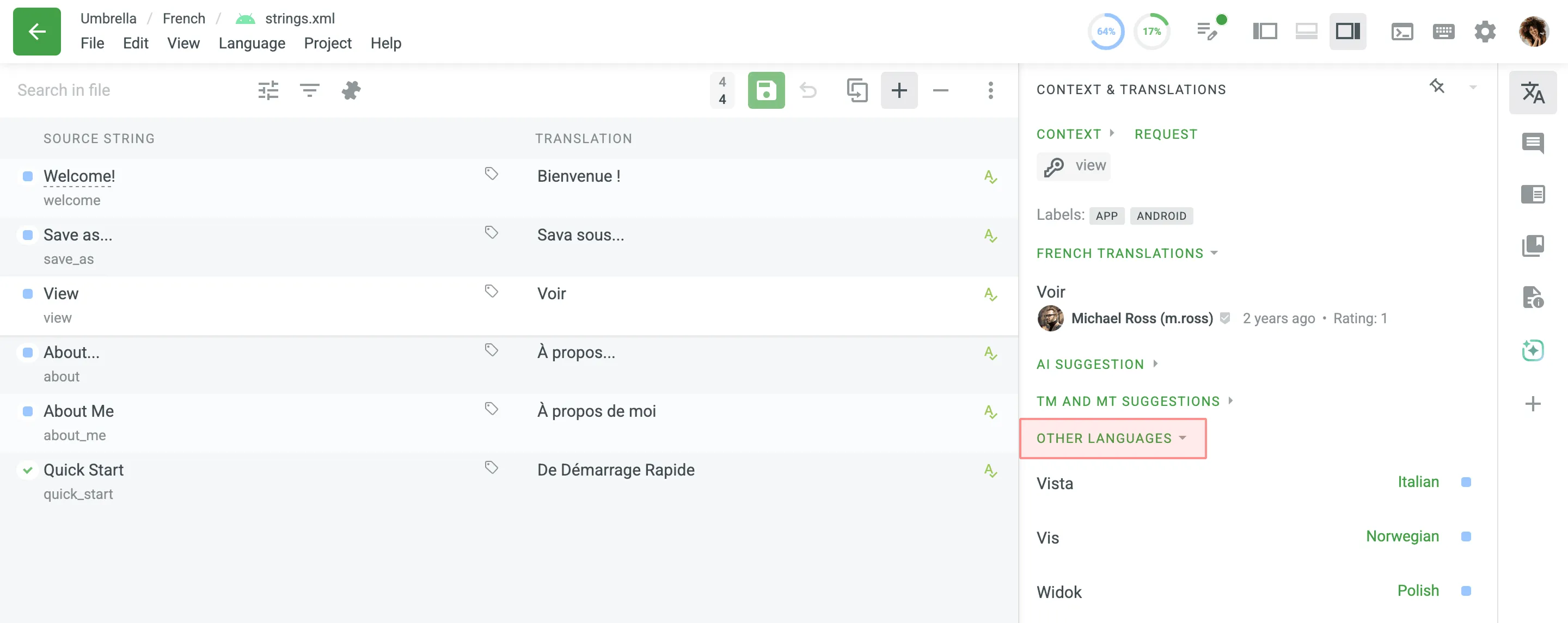

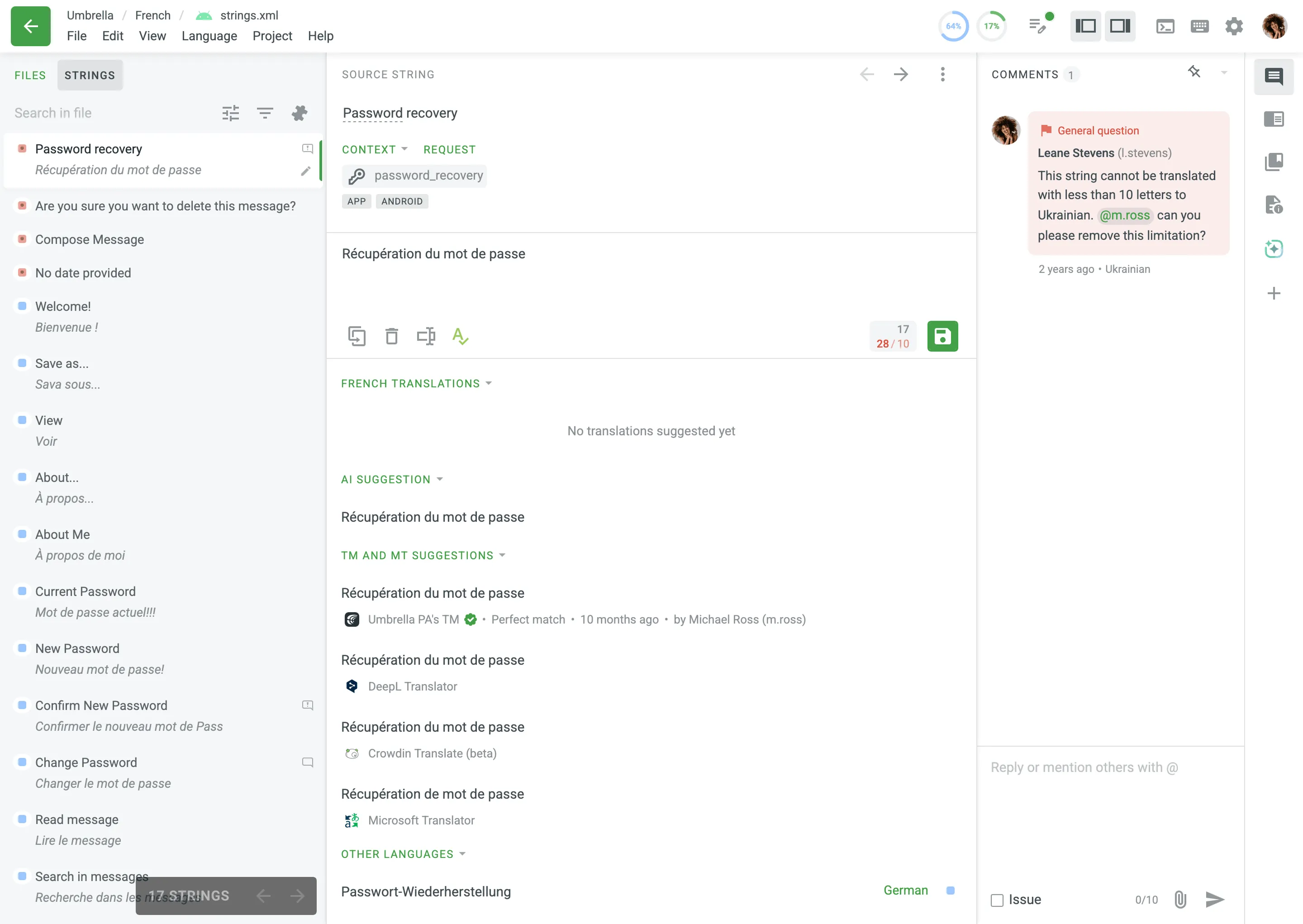

Click on one of the suggestions, and it will automatically appear in the translation field. Refer to it as a basis for your own suggestions.
The Other Languages section allows you to check the string translations into other target languages. This can be a useful tip for multilingual people and while translating dialects of a language. This view is available for reference even if you do not have permission to work on those specific languages.
Other languages
If you see that there is already a correct suggestion, vote for it by clicking the plus sign if you like the translation, or the minus sign if you don’t think the translation is correct. Translations that receive the most positive votes will have a higher rating and will appear at the top of all available translations for the string.
Vote

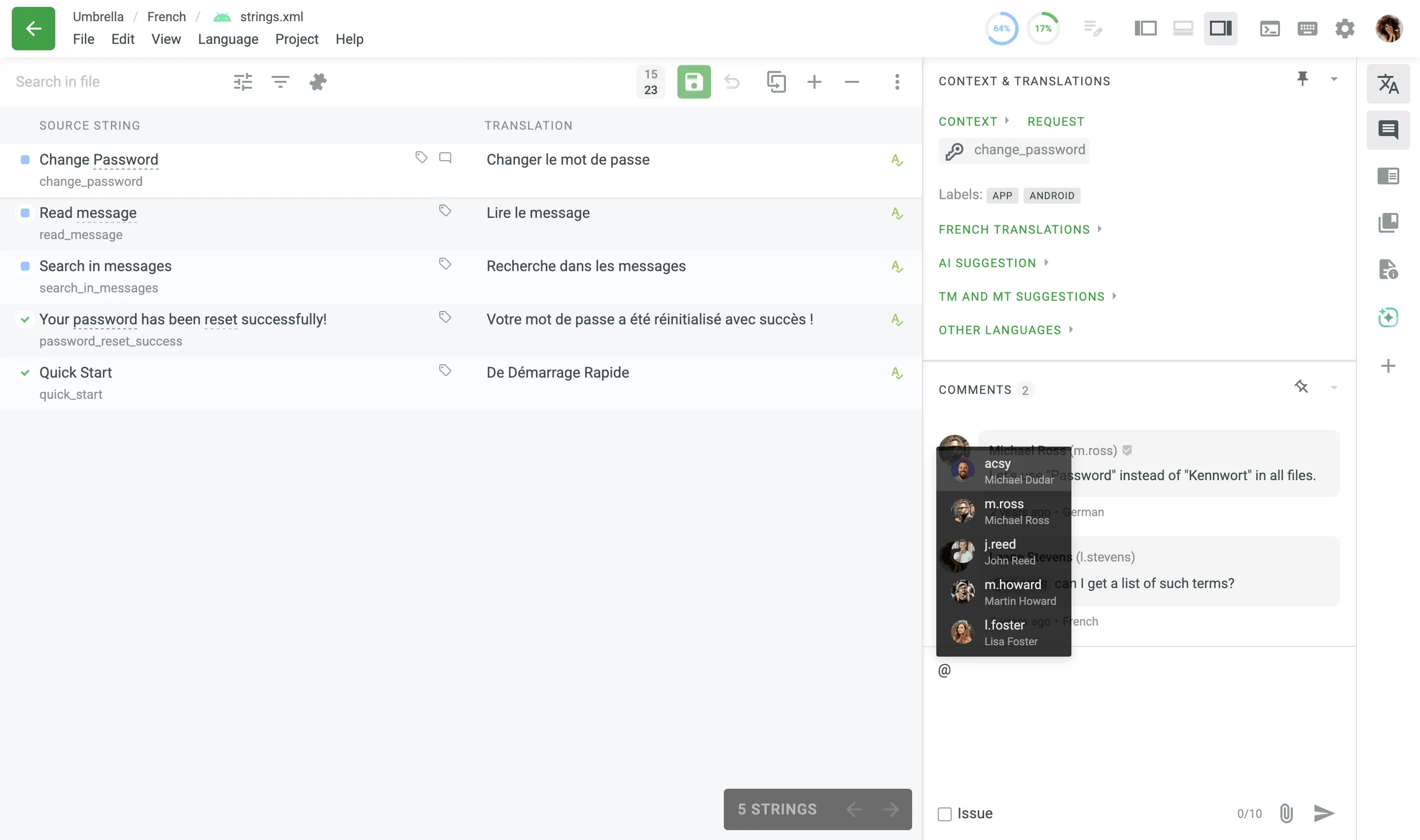

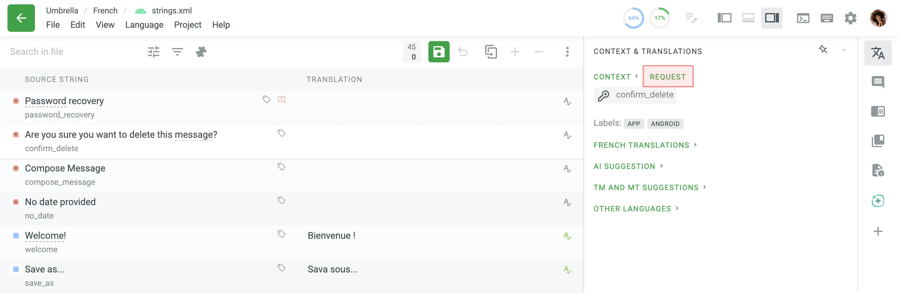

Request context
Using the Comments section, you can discuss the meaning of the source string or other related questions. It is recommended to use a source language of the project so other translators can understand it. Use the ”@” character and a username to direct your message to the specific person.
To provide additional context or clarify details, you can add attachments to your comments. You can upload up to 10 files to a single comment in the following ways:
  • Click Attach file.
  • Drag and drop files directly into the Comments section.
  • Paste files from the clipboard (e.g., Ctrl +V or Cmd +V ).
The Editor supports attachments in various file formats, allowing you to preview images and play video or audio files directly within the interface. If you attach multiple files, you can navigate through them using the pagination.
Hover over an attachment to access the following options:
  • Preview
  • Download
  • Delete
Comment

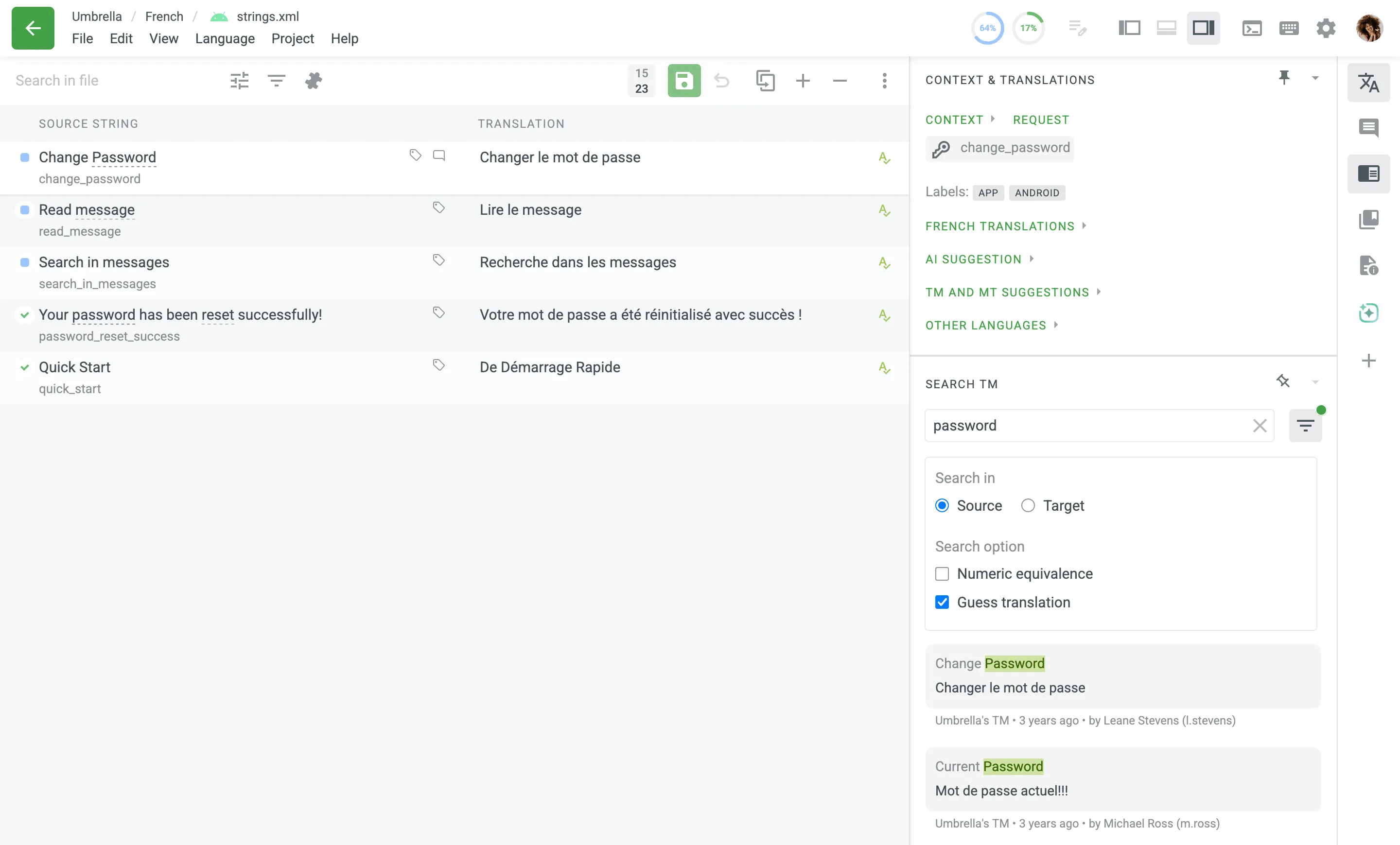

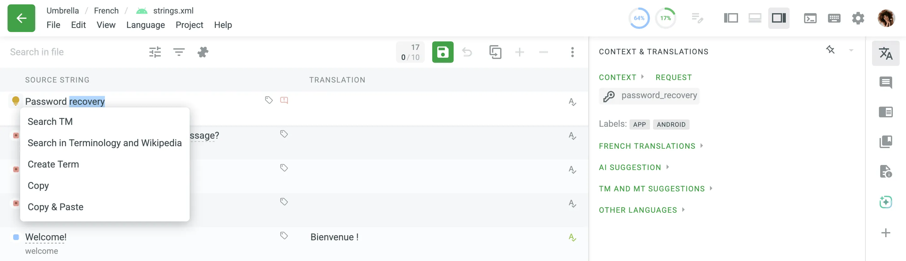

Using the Search TM section, you can check for all the available translations from Translation Memory, which is the vault of translations uploaded to the system by project managers. To help you find the best results quickly, the search prioritizes and displays the most relevant matches at the top of the list.
  • Source – Search for matches in a source language.
  • Target – Search for matches in target languages.
  • Guess translation – Highlight probable translation of a search phrase.
  • Numeric equivalence – Match digits from a search phrase with any other digits.
Additionally, to maximize your search results, you can use the following wildcards with your search phrase:
Type a minus sign (-) to exclude words from your search. Example: Save -as
Use quotation marks to find the exact combination of words. Example: “Save as”
Search TM

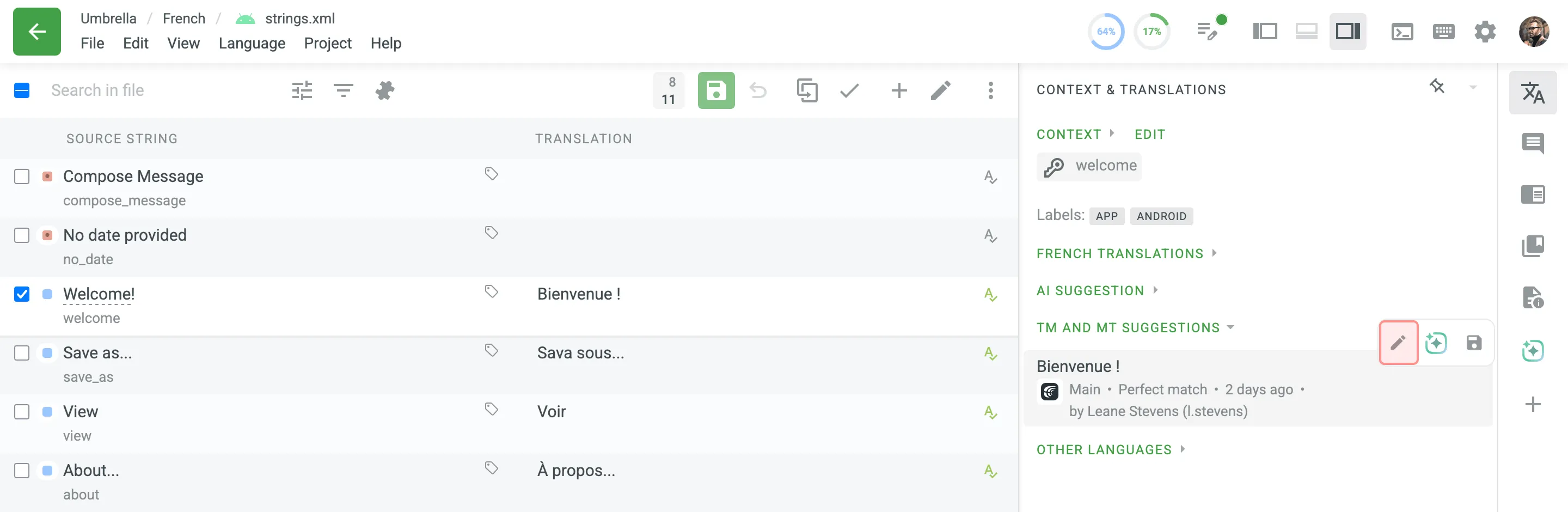

When working in the Editor, you can view the TM suggestions displayed in the TM and MT Suggestions section and in the right sidebar found through the Search TM section. There may be situations where TM suggestions contain inaccuracies or need to be updated.
Project members with manager permissions (or higher) can edit or delete TM records directly in the Editor, both in the TM and MT Suggestions section and in the Search TM section, rather than having to go to the Translation Memories page in the Resources or Project Settings. This ensures that TM suggestions are updated safely and quickly, improving the overall quality of the TM.
To edit the TM suggestion, follow these steps:
  1. Click in the TM and MT Suggestions section or Edit in the Search TM section. Edit TM Suggestions
  2. In the appeared dialog, make the necessary edits (i.e., modify or delete) to the TM suggestions for each language present in the TM segment.

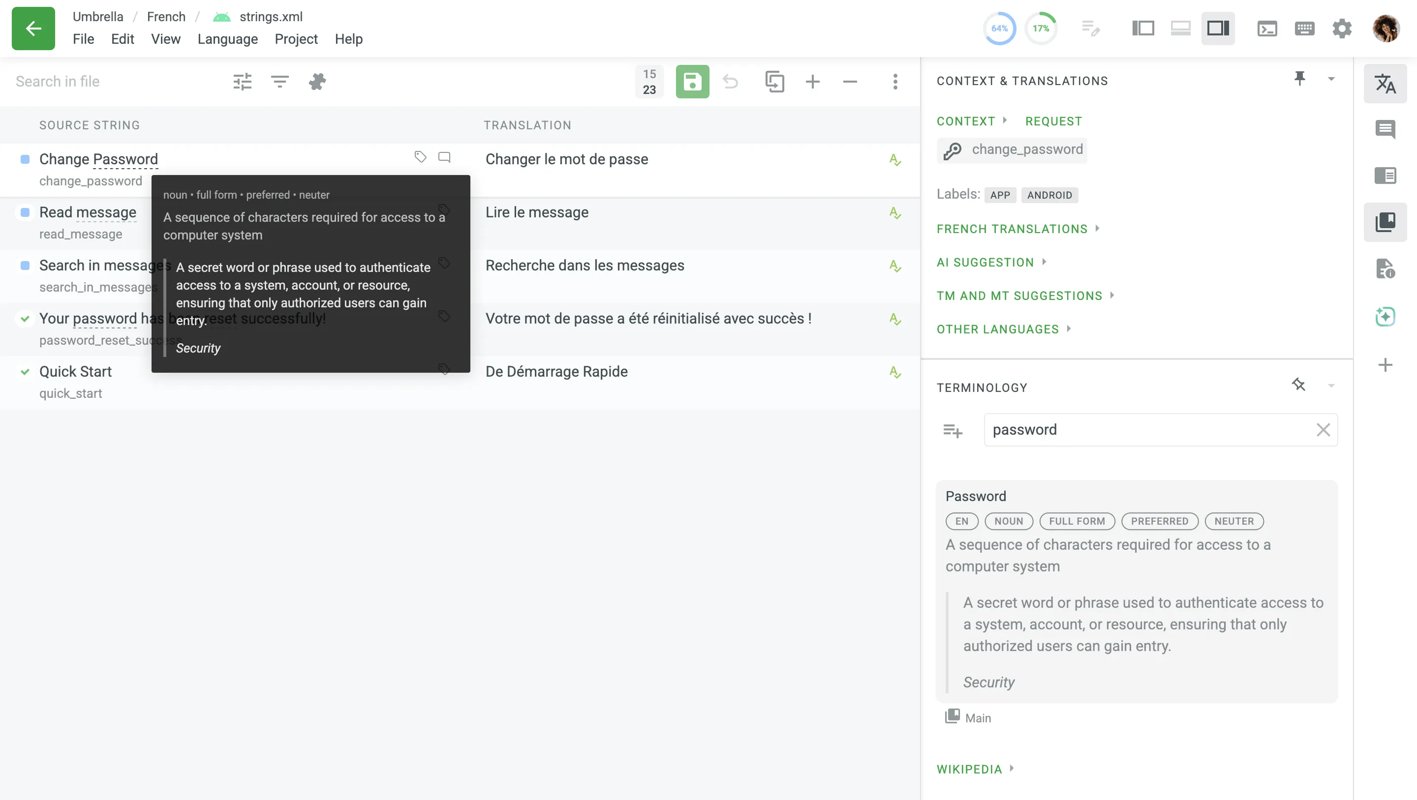

Underlined words or phrases in strings indicate project-specific terminology, which should be translated according to the provided term description. You can view detailed explanations by hovering over the underlined text or visiting the Terminology section.
The Terminology section allows you to browse the project glossary (if available) and search for specific terms. If a term is not found in the glossary, Wikipedia explanations will be displayed as a reference.
Some terms may already have translations, which help maintain consistency across the project. To reuse a translated term, simply click on the underlined text, and its translation will automatically appear in the translation field.
Terminology

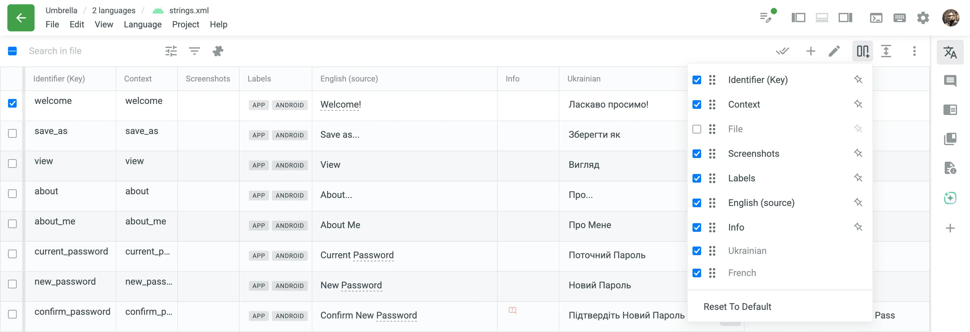

The multilingual mode provides similar features as the side-by-side mode and allows multilingual translators and proofreaders to work with multiple languages at the same time. You can select up to ten languages to work with simultaneously. The right panel shows the string’s translations of the language you’re entering a translation for or the one that was selected last.
Multilingual Mode
Once you switch to the multilingual mode, select the languages you’d like to work with, and click Apply. To add new languages or remove some of the earlier selected ones, go to Language in the main menu, then do the necessary modifications to the language list and click Apply.
In addition to the multilingual mode, there is a separate Multilingual (Grid) mode. It provides a spreadsheet-like layout where each language is shown in a separate column, allowing you to work with multiple languages in a compact tabular format.
Additionally, to pin or hide individual columns, click the drop-down arrow next to a column title and choose the needed option.
You can also switch between Default View and Compact View using the button in the upper-right corner. The compact option displays more rows by reducing vertical spacing.
Multilingual Mode Grid View

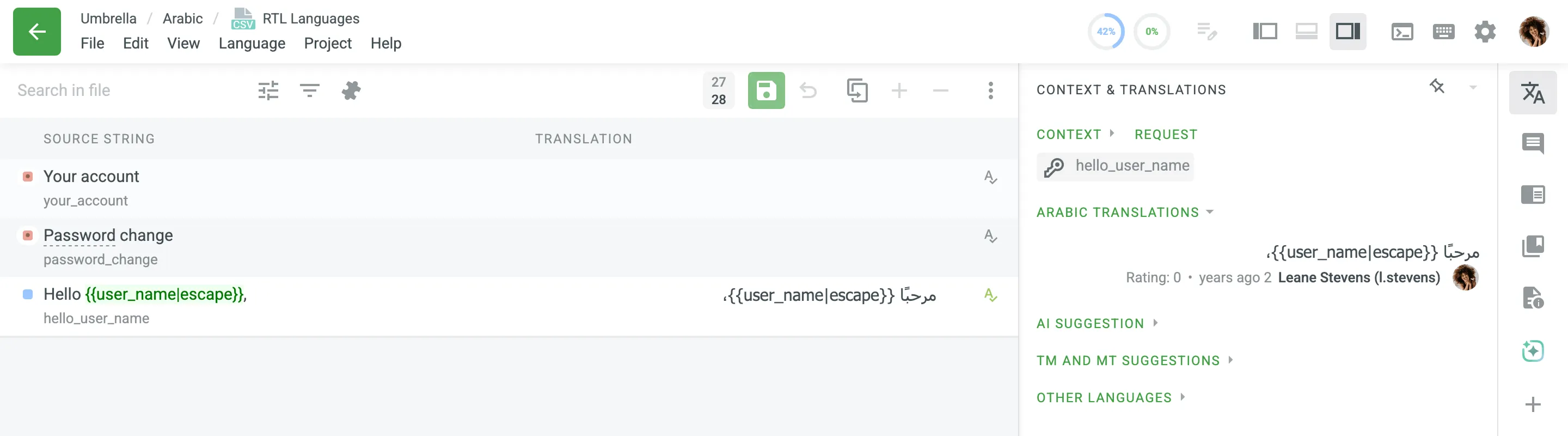

When translating between LTR and RTL languages, some elements in the translation field in the Editor might not be displayed the same way as they will be once exported.
To be sure that RTL translations will be displayed correctly in the exported file, we recommend making translations the following way:
  1. Click under the source text (or Alt +C key combination).
  2. Translate the source texts into the target language.
  3. Leave variables, tags, etc., unchanged in the translation, even if they look wrong. They will be in the right positions in the exported file.

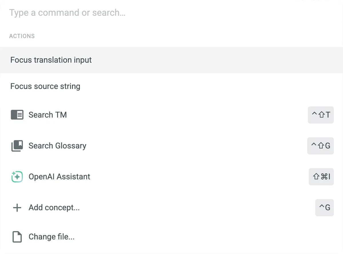

The Command Palette in the Editor is your hub for accessing various commands efficiently. It serves as a central location for all available commands, ensuring a seamless and intuitive experience.
To open the Command Palette, click in the upper-right corner.
Command Palette
  • QA issues – if enabled, the pop-up messages with warnings will appear each time you try to save a translation with some inaccuracy (punctuation/tags/spaces mismatch, missing variables, etc.) QA pop-up

  • Search TM – Look for Translation Memory (TM) suggestions for the selected word or phrase.
  • Search in Terminology and Wikipedia – Find an explanation of the selected word or phrase in the project terminology or Wikipedia.
  • Create Term – Add the selected word or phrase to the project glossary as a new term.
  • Transform (only available for selected words in the translation) – Access a submenu with options to convert the selected text to lowercase or uppercase.
  • Copy – Copy the selected word or phrase to clipboard.
  • Copy & Paste – Copy the selected word or phrase and immediately paste it into the translation field.
Search TM section
  • In Side-by-Side, Multilingual, and Multilingual (Grid) Modes – You can show or hide the file browser panel by clicking the icon in the upper-right corner or by using the keyboard shortcut Ctrl +[ . Alternatively, you can open the panel by selecting File > Open from the main menu or with the keyboard shortcut Ctrl +O or Cmd +O .

In addition to the WYSIWYG file preview, which shows files as they would appear when rendered, there are Source File Preview and Translated File Preview modes that allow users to view the raw content of both source and translated files directly within the Editor. These previews provide insight into the file’s structure, layout, and formatting, helping users ensure accurate translations within the correct context. This is particularly helpful for identifying discrepancies or formatting issues without leaving the Editor. While the Translated File Preview is available to all users, the Source File Preview is restricted to members with Developer / Translation Requestor permissions or higher.
To open a file in either of these previews, go to File in the main menu, and select the needed file preview mode.

  1. Open the String menu by clicking in the upper-right and select Pre-translate.
  2. Select the preferred pre-translation method.
  3. Configure the following pre-translation parameters:
    • Scope – select which strings to apply pre-translation to:
      • File – applies to the currently opened file.
      • All files – applies to all strings across all files in the project, regardless of the file currently open in the Editor.
    • Translate from – select the language to use as the source for pre-translation. By default, it’s preselected to the project’s source language, but you can choose any other project language. This provides greater flexibility and may improve translation quality by allowing you to use a more suitable existing translation (e.g., an adapted English version instead of the original Japanese) or translate directly between related languages (e.g., Spanish to Portuguese).
    • Apply to untranslated strings only – when selected, pre-translation will only be applied to strings that don’t have any translations.
    • Allow duplicate translations – adds translations even if they duplicate existing ones. Useful when comparing AI prompts or MT engines in the Pre-translation Accuracy report, as it ensures that all translations are registered as new and included in accuracy calculations.
    • Minimum match ratio (Specific to pre-translation via TM) - select either 100% or Perfect match (101%) as the minimum similarity required for TM matches.
    • Skip approved translations (Specific to pre-translation via TM and MT) – prevents overwriting strings that already have approved translations.
    • Approve added translations (Specific to pre-translation via TM) – allows you to auto-approve translations added through pre-translation. Options include:
      • All (skip auto-substituted translations) – approve everything except translations improved by auto-substitution.
    • Translation engine (Specific to pre-translation via MT) – select the machine translation engine to use.
    • AI prompt (Specific to pre-translation via AI) – select the prompt that will guide the AI model’s behavior during pre-translation.
  4. Click Pre-Translation.
In Side-by-side and Comfortable modes, pre-translation is applied to the single language currently selected in the Editor. In Multilingual mode, translations are applied across all selected languages, as this mode allows working with multiple languages simultaneously.
Use the Queue option in the String menu to track and manage all triggered pre-translation instances.
Read more about Pre-translation Queue.
You can create a custom filter for strings by clicking the Filter strings icon and choosing Advanced Filter. This feature helps you locate specific strings faster by allowing you to combine multiple filter parameters and define a custom sort order.
Advanced Filter
The filter dialog contains the following parameters, which you can combine to narrow down your search:
  • Strings Added – Filter strings that were imported into the project within a specific date range.
  • Strings Updated – Filter source strings that were updated within a specific date range.
  • Translations Updated – Filter strings where translations were added or updated (including new suggestions, approvals, or votes) within a specific date range.
  • Verbal Expression – Filter strings using complex structural patterns.
  • Labels – Include or exclude strings based on their assigned labels.
  • Translations – Filter by translation status. Options include Untranslated, Partially Translated (Plurals), Translated, Same as Source String, and Modified Source Strings.
  • Duplicates – Filter strings based on their duplicate status. Options include Master Strings, Duplicates Only, Duplicates with Shared Translations, and Duplicates with Own Translations.
  • Approvals – Filter strings by their approval status. Options include Translated, Not Approved, Partially Approved (Plurals), Approved, and Have Translations After Approval.
  • TM, MT and AI – Filter strings based on their translation origin. Options include Translated by MT, Translated by TM, Translated by AI, or Translated by TM or MT or AI.
  • Pre-translation – Filter strings based on whether pre-translation was applied. Options include Used or Not Used.
  • Comments – Filter strings by comments or issues. Options include Do Not Have Comments, Have Comments, Unresolved Issues, General Question Issues, Current Translation Is Wrong Issues, Lack of Contextual Information Issues, or Mistake in Source String Issues.
  • Screenshots – Filter strings that are With Screenshots or Without Screenshots.
  • Visibility – Filter strings by their visibility to translators: Visible or Hidden.
  • QA Issues – Filter strings based on quality assurance issues. Options include Without QA Checks, QA check in progress, All issues, or specific errors like Tags mismatch, Spelling mistakes, and Punctuation mismatch.
  • String Type – Filter by string format. Options include Simple String, Plurals, or ICU.
  • Votes – Filter strings by the net number of votes. Options are Greater Than or Less Than a specified number.
  • Translated By – Filter for strings Translated By or Not Translated By a specific project member.
  • Approved By – Filter for strings Approved By or Not Approved By a specific project member.
The Advanced Filter also supports Verbal Expressions, which allow you to find strings that match specific structural patterns, such as the placement of variables, formatting, or punctuation, rather than matching exact text.
  • Verbal Expression – Enter the pattern you want to search for.
  • Scope – Define where to search for the pattern. Options include Strings, Context, Translations, Identifier (Key), or Everything.
For a quick way to filter by a single label, you can click on any label tag displayed in a string’s context area. Hovering over a label will display a tooltip that reads Filter by label: {label-name}. Clicking the label instantly applies the Advanced Filter with that specific label selected and the Labels: Include Any rule. All other filter parameters are cleared. If you then click a different label, it will replace the previous one in the filter.
For more complex queries involving multiple labels, you can set rules to include or exclude strings:
  • Labels: Include All / Labels: Include Any – use this drop-down menu to choose the logic for including labels. Then, add the desired labels in the corresponding field.
    • Include All: includes only strings that have all of the selected labels (AND logic).
    • Include Any: includes strings that have at least one of the selected labels (OR logic).
  • Labels: Exclude All / Labels: Exclude Any – use this drop-down menu to choose the logic for excluding labels. Then, add the desired labels in the corresponding field.
    • Exclude All: excludes only strings that have all of the selected labels (AND logic).
    • Exclude Any: excludes strings that have at least one of the selected labels (OR logic).
This allows you to narrow or expand the filtered results depending on your needs.
  • Include example – to find strings tagged with both ui and button, select Labels: Include All and add those two labels.
  • Exclude example – to exclude all strings tagged either marketing or deprecated, select Labels: Exclude Any and add those two labels.

Once a translator or proofreader has a task assigned, all the task details are accessible from the Editor.
The name of the task is displayed in the navigation path in the upper-left corner. Hovering over the task name reveals a popover with additional details, including the task ID, a direct link to the task, due date, the target language, the task type, and the assignee.
Task name
When working on a task, the standard File menu is replaced by the Task menu. You can access it by clicking Task in the main menu. It contains the following options:
  • File and string navigation options (Open, All Strings, File Previews)
  • Options to Export and Upload translations for the particular task
  • Project Strings – select this option to quit the particular task editor and show all project strings.
