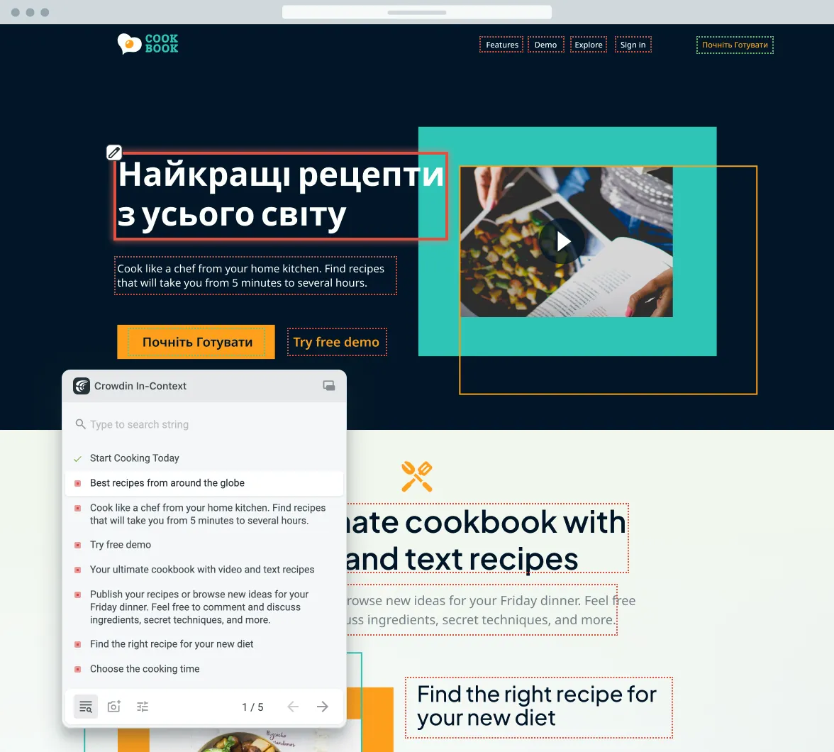

This tool provides a view of your application with editable texts, so the translation process is real-time visible. Even the dynamic part of the application and strings containing placeholders can be translated this way.
Integrated pseudo-language contains special identifiers instead of the original texts. Thus when switching your app to that language, all labels are converted to special identifiers. Javascript searches for those identifiers and replaces them with editable labels. So, the In-context page of your web app will look the same as your application, with the only difference that translatable strings will be editable.
In-Context View
Translations are made directly in the app, with no need to open the Editor. A simplified version of Crowdin Editor will be displayed, with all the functionality (TM, machine translation, approve/vote option, comments, terms) provided. Thus, it’s easier to make and review translations since translators can preview them in a real context.

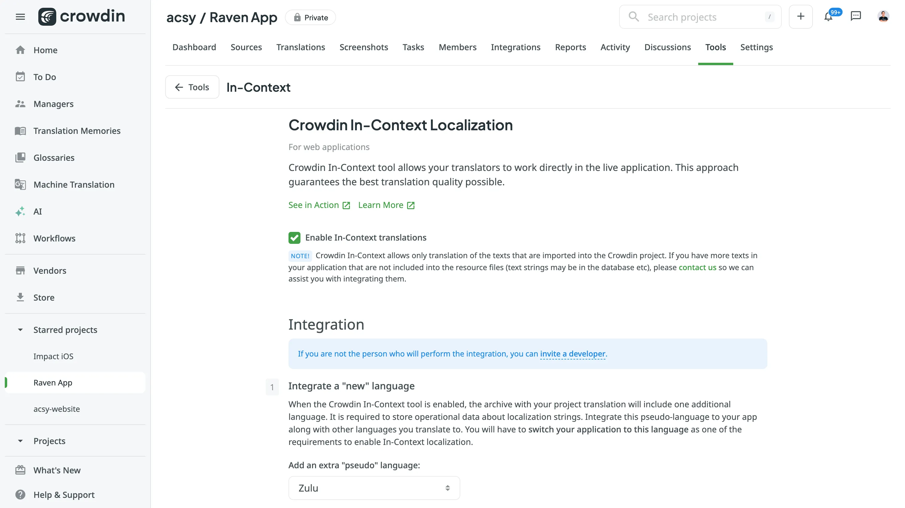

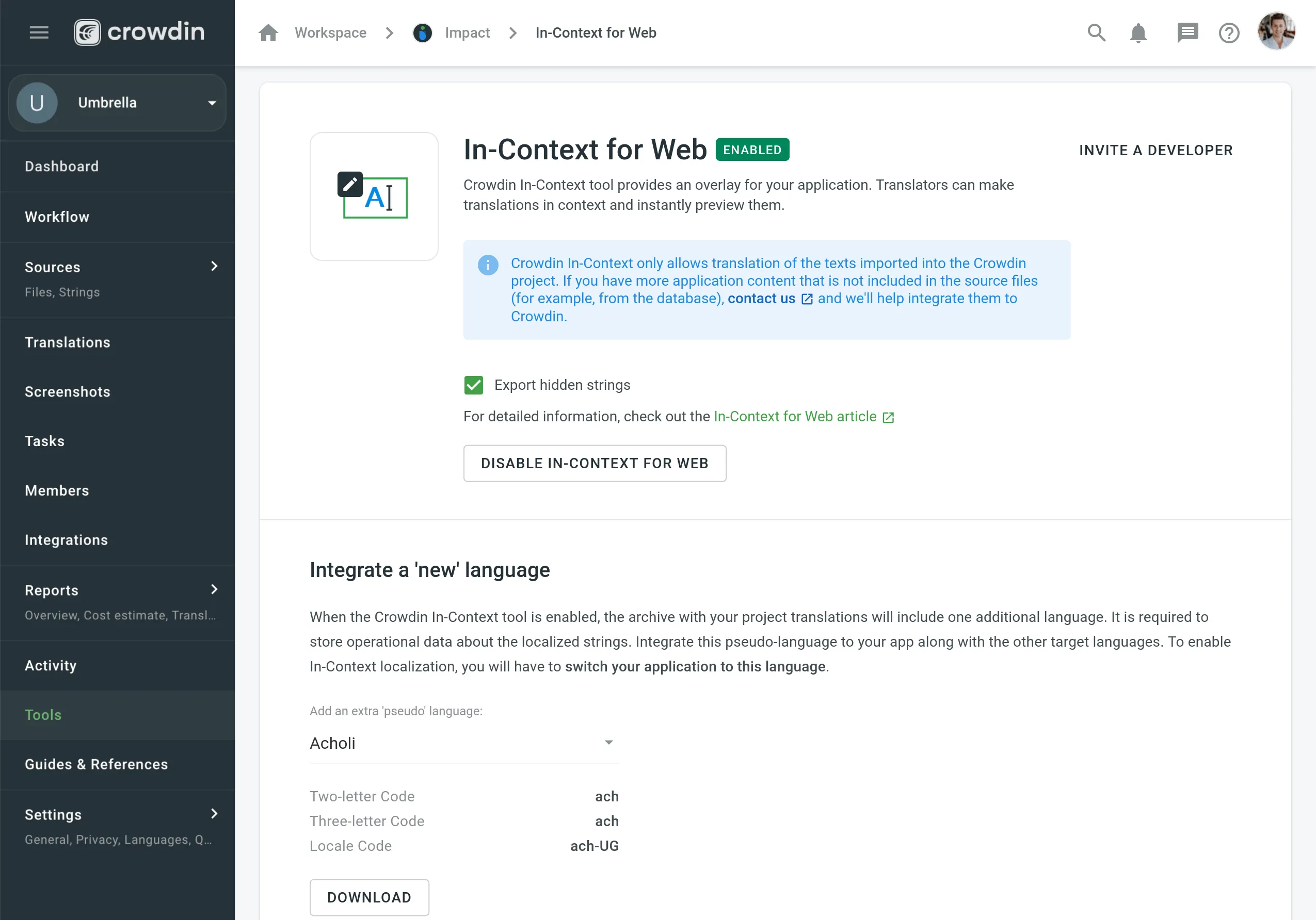

Follow the integration setup guide in your Crowdin project to set up In-Context. The guide can be found in your project, under Tools > In-Context.
In-Context Tab in Crowdin

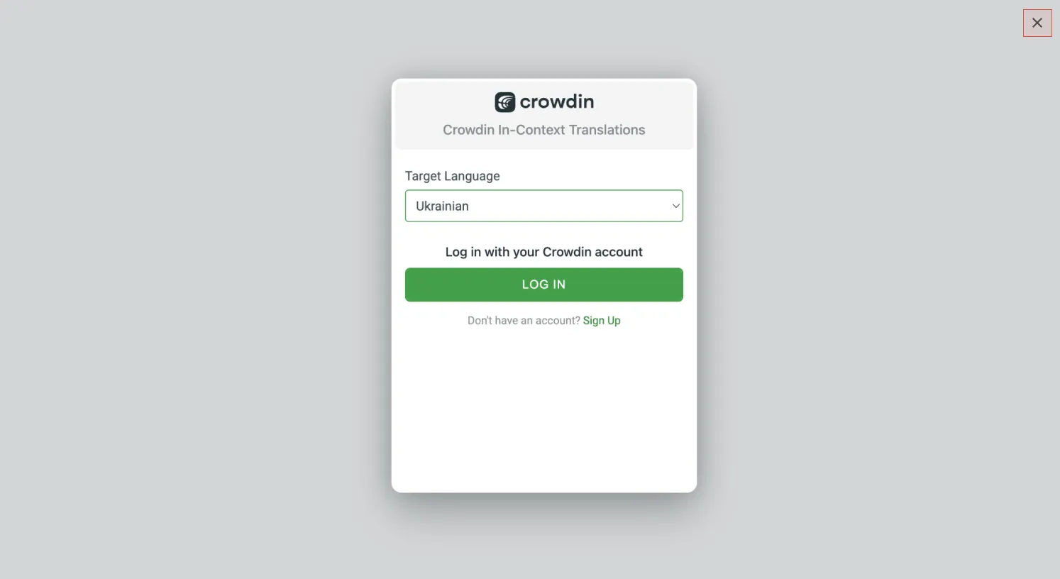

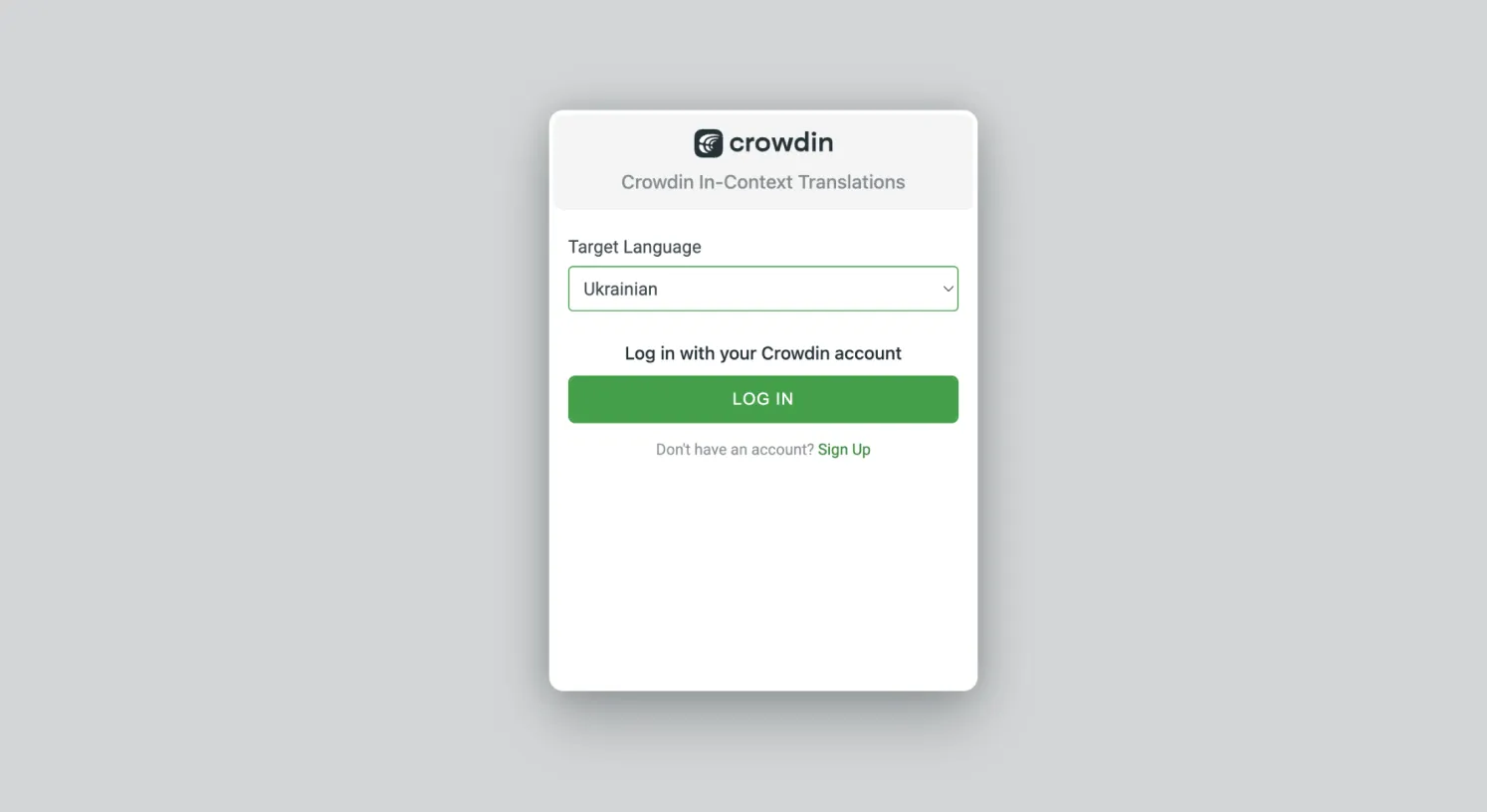

After the integration is successfully set up and you have refreshed your application, you should see the invitation dialog and Crowdin login box.
Login Window

Close Login Window

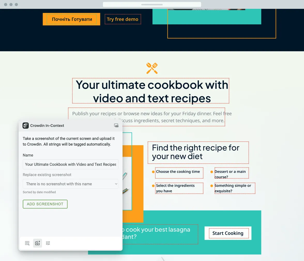

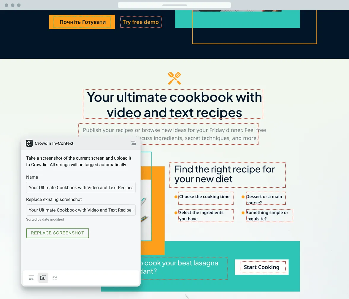

Adding Screenshots via In-Context
This feature allows you to take a screenshot of the opened website page, upload it to the Crowdin project and automatically tag all strings used on the page.
Read more about Screenshots.
Add Screenshot
