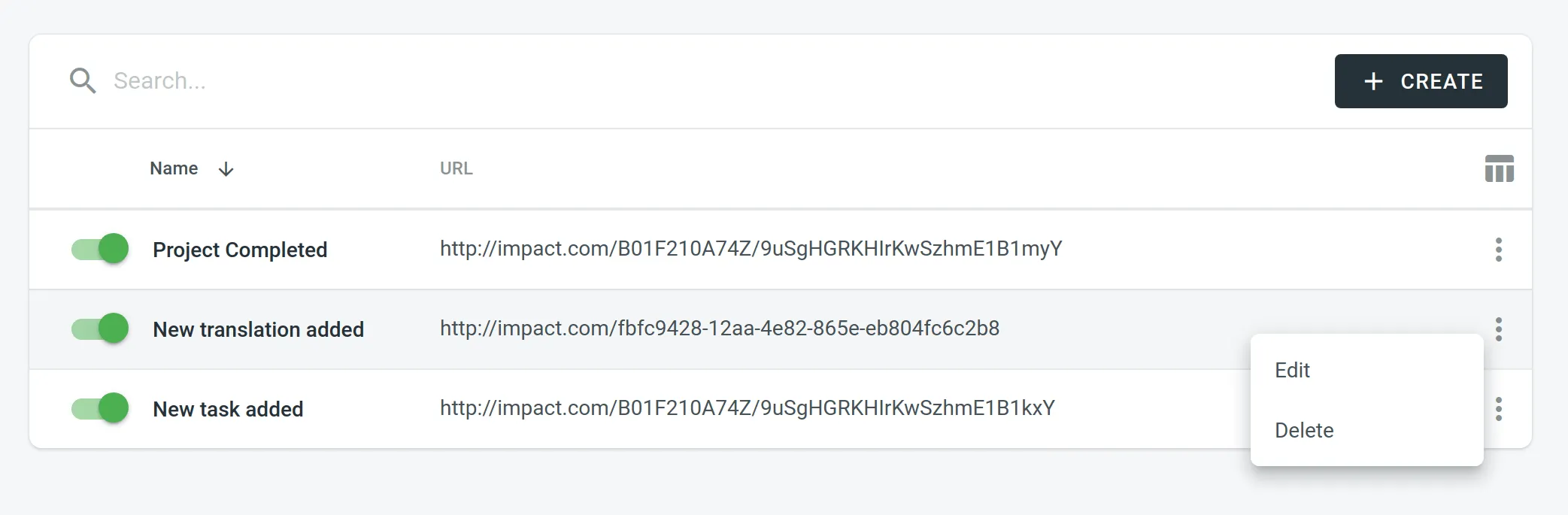

You can access the list of all existing webhooks within a specific project. You will be able to edit or delete webhooks right from the list of webhooks displayed.
Manage Webhooks

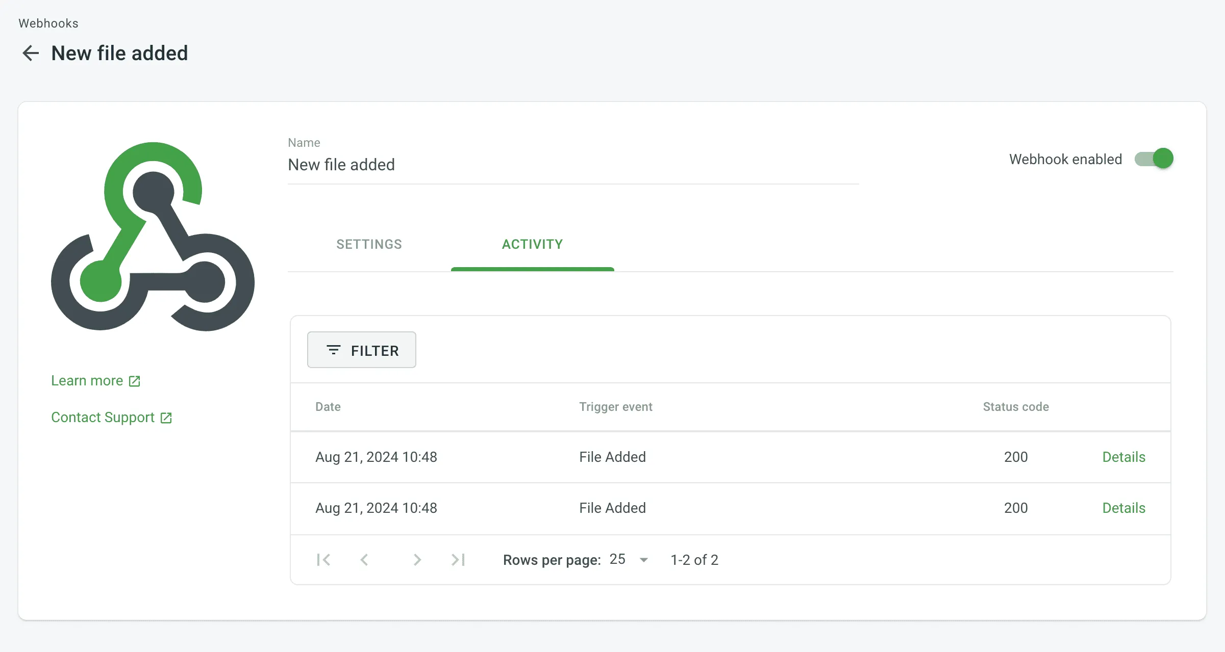

After the events are triggered, you will be able to review the activity of each webhook separately. Use the filter to review all or only unsuccessful webhook notifications.
Webhooks Activities

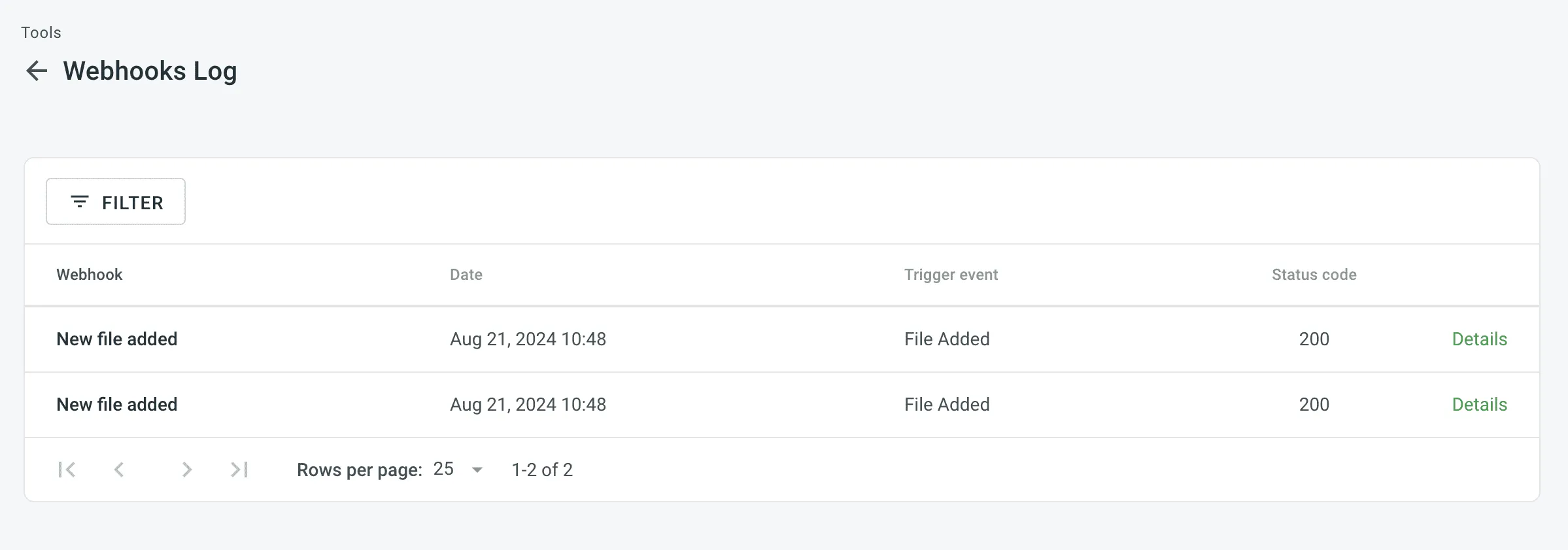

Alternatively, you can review the full list of sent webhooks in the Webhooks Log. Filter webhook notifications by result (Any or Unsuccessful), event types, or name.
Webhooks Log
