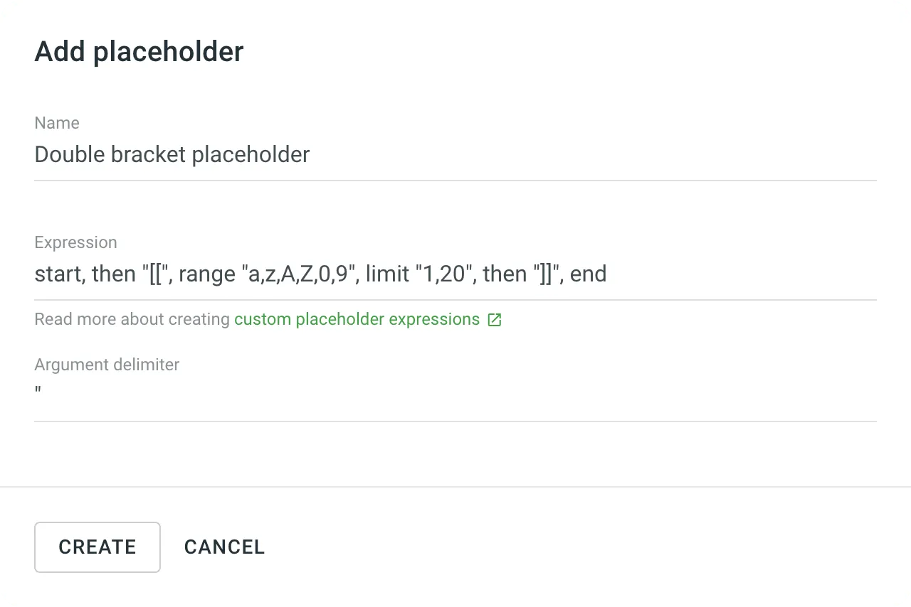

  2. Switch to the Custom placeholders page on the left menu bar and click Add Placeholder
  3. In the appeared dialog, specify a custom placeholder expression using the Expressions syntax elements and click Create.
Custom placeholders syntax elements
To configure your custom placeholder expression, you can use the elements from the expression syntax table. For example, if you’d like to highlight this [[Placeholder1]], your expression might look like this: start, then "[[", range "a,z,A,Z,0,9", limit "1,20", then "]]", end
To simplify things a bit, let’s deconstruct the expression above.
start – indicates the beginning of the expression.
then "[[" – means that your custom placeholder starts with two opening square brackets.
range "a,z,A,Z,0,9" – means that your custom placeholder might include characters ranging a-z and/or A-Z and/or 0-9.
limit "1,20" – means that the length of the placeholder is from 1 to 20 characters.
then "]]" – means that your custom placeholder ends with two closing square brackets.
end – indicates the end of the expression.
