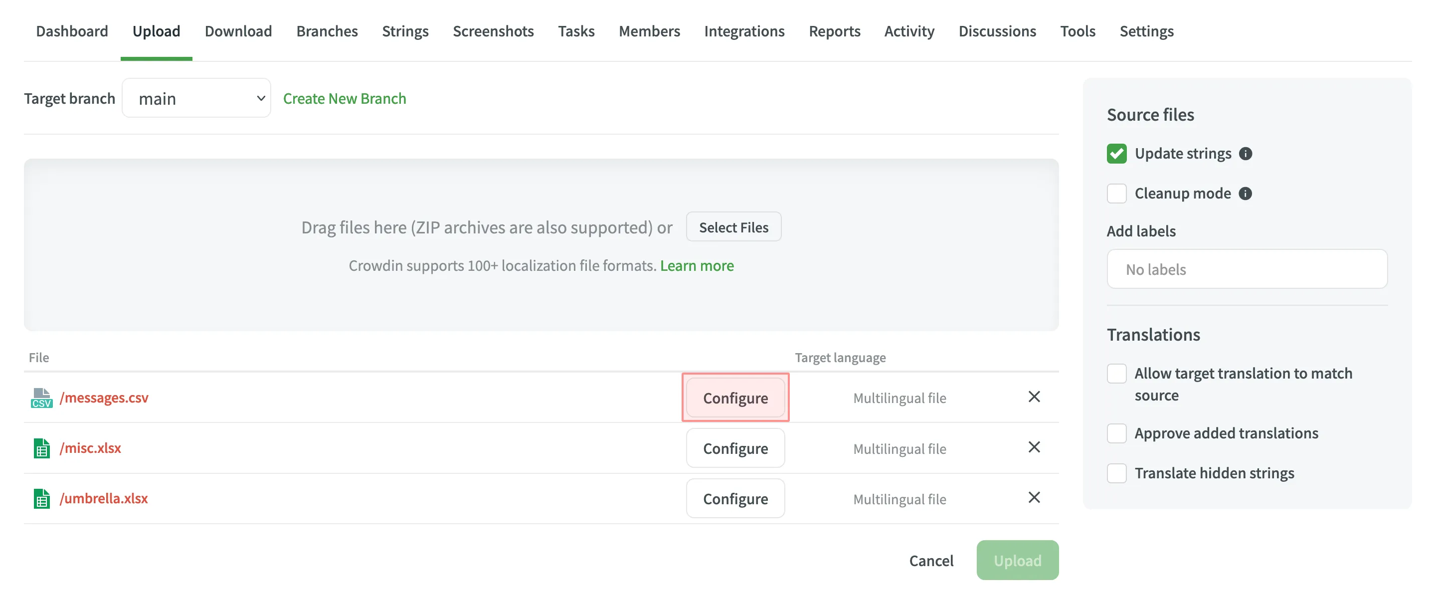

  1. Open your project and go to Sources > Files.
  2. Click Configure next to the file to open the configuration dialog.
Configure File

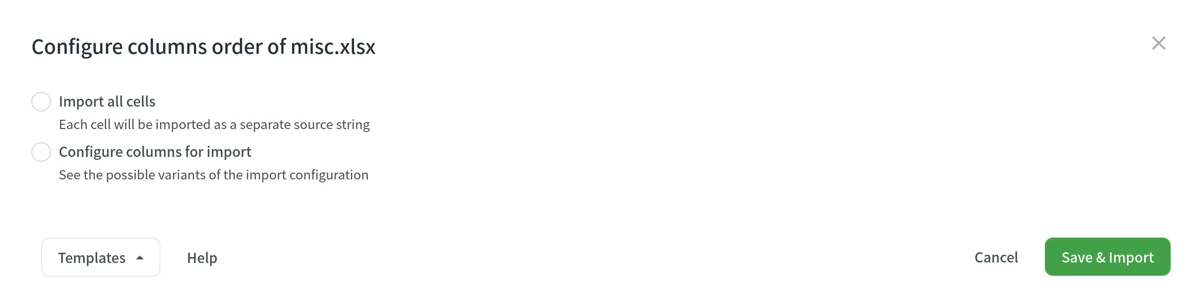

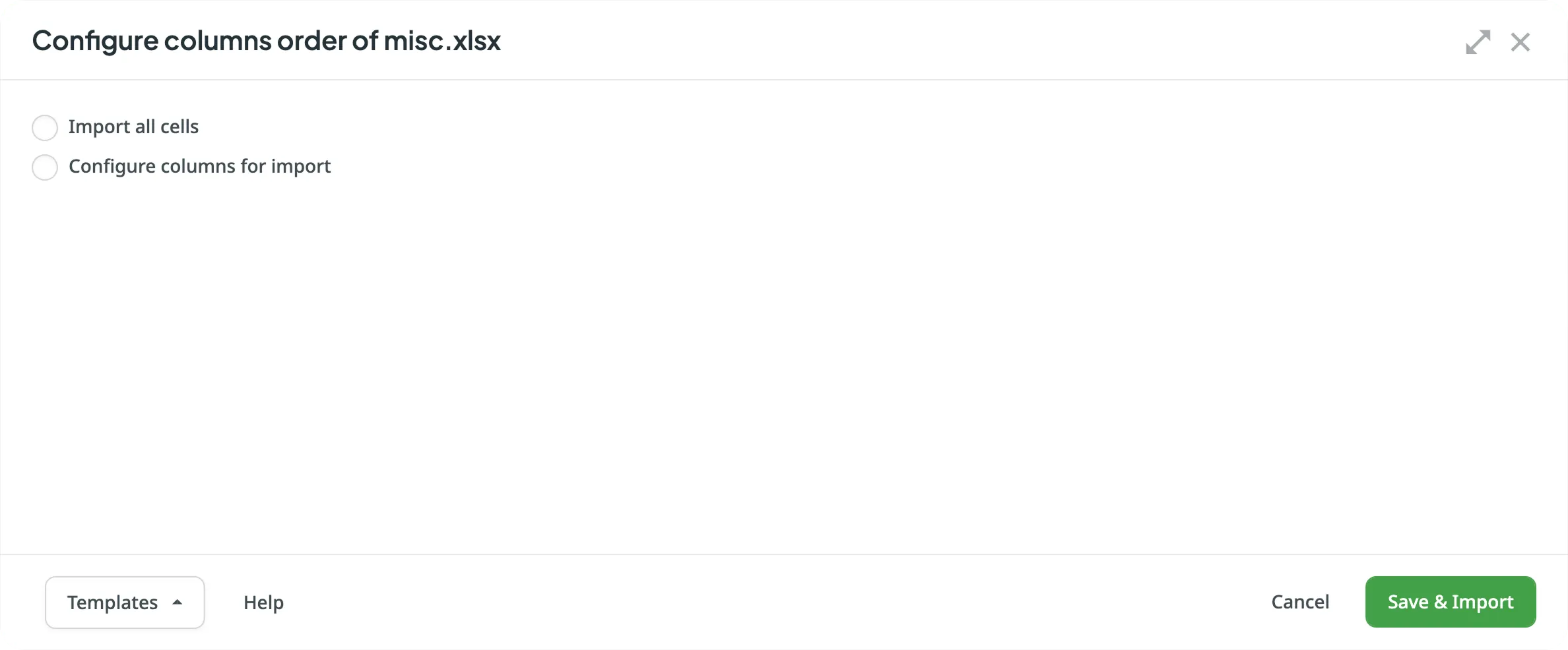

When configuring an XLSX file, you will first see a dialog with two primary options that determine how the file is processed:
  • Import all cells - Imports the content of each cell as a separate source string. If you select this option, you can also enable Content segmentation to automatically split text into smaller translation units, such as sentences or short paragraphs. This is helpful when translating content units consisting of several sentences because it will be easier to translate smaller pieces of text. Segmentation Rules eXchange (SRX) are used for automatic content segmentation.
  • Configure columns for import - This option opens the detailed configuration dialog, allowing you to manually map columns for sources, translations, context, and more.
Initial configuration options for XLSX files

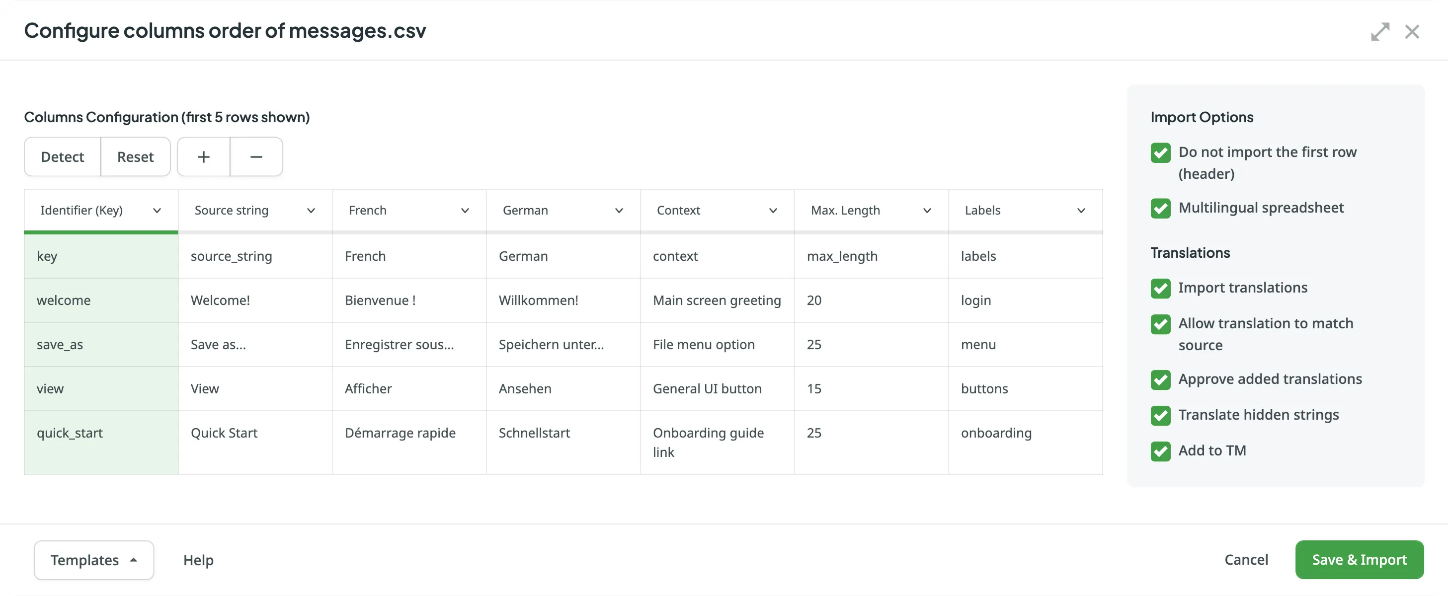

The main area of the dialog is for mapping the columns from your file to the appropriate data type in Crowdin. The interface includes the following controls directly above the column mapping:
  • Detect - Re-runs the automatic detection of the column scheme based on the headers in the first row.
  • Reset - Clears the current column configuration and resets all columns to Not selected.
  • and - Use these buttons to add a new language column or remove a selected one. This is useful if your multilingual source file is missing columns for some of your project’s target languages. These buttons are active only when you select the Multilingual spreadsheet option in the Import Options section.

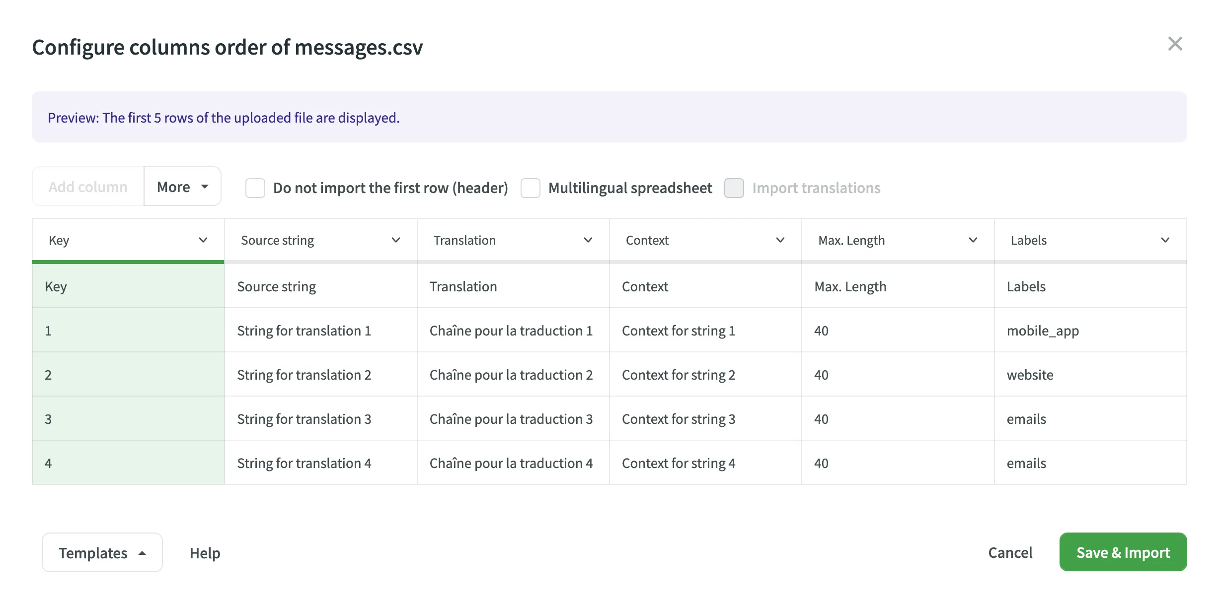

You can define the purpose of each column by assigning a type from the dropdown menu above it. The available column types are:
  • Key – Column contains string identifiers. Typically, an alphanumeric value.
  • Source string – Column contains source strings that should be translated.
  • Source string/Translation – Column contains source strings, but the same column will be filled with translations when the file is exported. When uploading existing translations, the values from this column will be used as translations.
  • Translation – Column for resulting translations added on export. On import and when uploading existing translations, the system will check this column for existing translations and upload them to the project.
  • Context – Column contains comments or context information for the source strings.
  • Labels – Column contains labels for the source strings. You can add multiple labels to each string, separating them with commas.
  • Max. Length – Column contains max.length limit values for the translations of the strings.
  • Not selected – Column will be skipped on import.
Detailed configuration dialog for a CSV file
When you open the configuration dialog, the system automatically detects the file scheme based on the column names in the first row. The detection is case-insensitive. Columns that aren’t detected automatically will be left as Not selected for manual configuration.
Automatic column detection is especially helpful when you upload multiple multilingual spreadsheets that contain many languages and additional columns (e.g., Context, Labels, Max. Length).
By default, the system initially treats spreadsheets as monolingual. To correctly autodetect columns containing translations for multiple languages, select Multilingual spreadsheet in the Import Options section, and then click Detect.

The sidebar on the right allows you to define how the file structure is handled.
  • Do not import the first row (header) - Select this option if the first row of your file contains column headers that should not be imported for translation.
  • Multilingual spreadsheet - Select this option if your file contains source texts in one column and translations into different languages in other columns. This enables the system to correctly map languages to the appropriate columns and unlocks the Translations section.
  • Import hidden sheets (XLSX only) - Import content from hidden sheets within your XLSX file.
  • Import hidden rows (XLSX only) - Import content from hidden rows within your XLSX file.
Use this set of options, also in the right sidebar, to fine-tune how existing translations from your file are processed. Import translations becomes available when Multilingual spreadsheet is selected, and the other options become available when Import translations is selected.
  • Import translations: Import the translations present in the file along with the source strings. By default, this option is selected for XLSX and CSV files. In file-based projects, it is cleared for CSV files of 5 MB or larger.
  • Allow translation to match source: Enable this if a translation is intentionally the same as the source text (for example, for product names, brands, or code terms).
  • Approve added translations: Automatically approve the uploaded translations. This is useful when you are confident in the accuracy of the translations in your file.
  • Translate hidden strings: Import translations for strings that are marked as hidden in Crowdin. Hidden strings are typically not visible to translators in the Editor and are used for system purposes or placeholders.
  • Add to TM: Add the imported translations to the project’s primary Translation Memory (TM).
