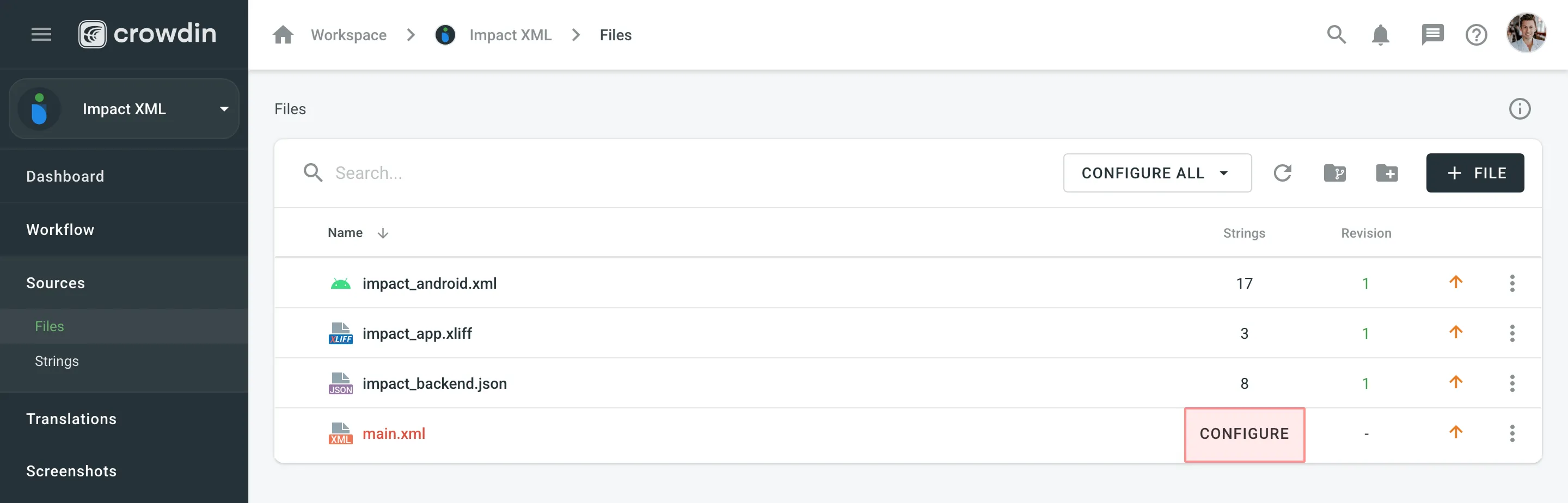

  1. Open your project and go to Sources > Files.
  2. Click Configure next to the file to open the configuration window.
  3. Select which content should be translated and click Save & Import to proceed.

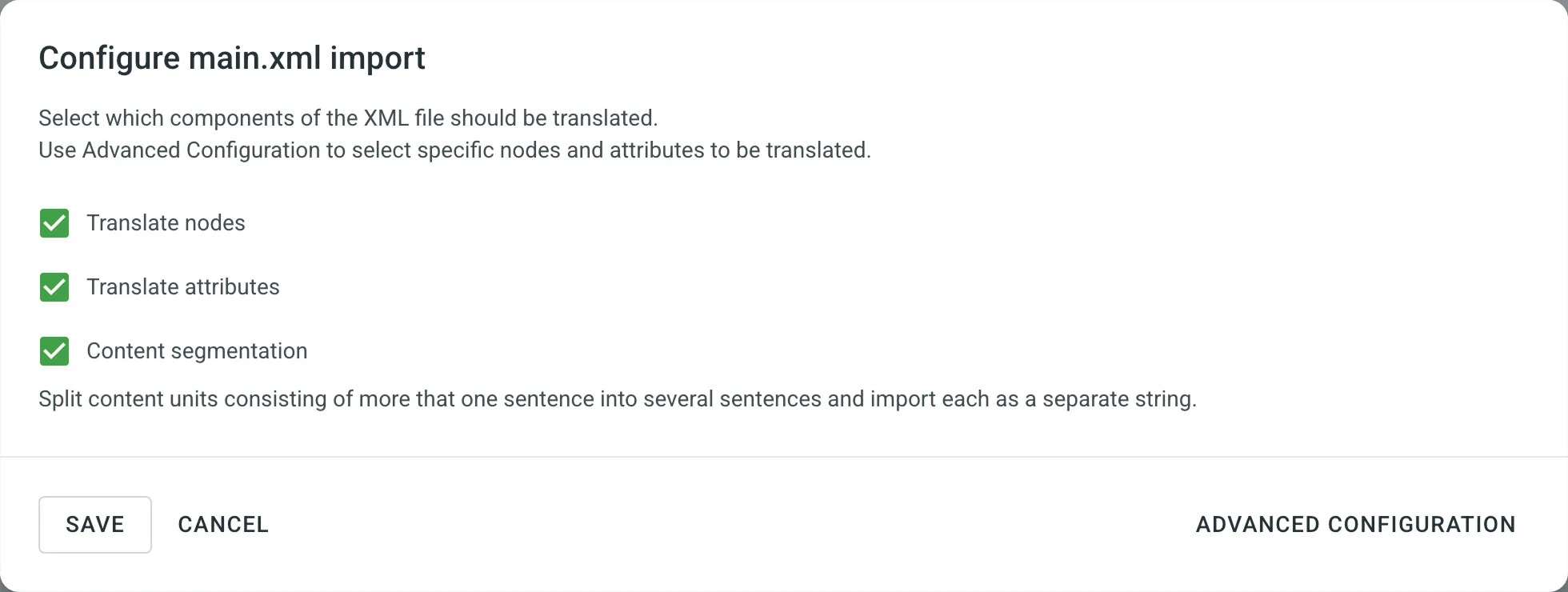

Basic Configuration
Basic Configuration allows you to select all nodes and/or all attributes to be available for translation.
XML Basic Configuration

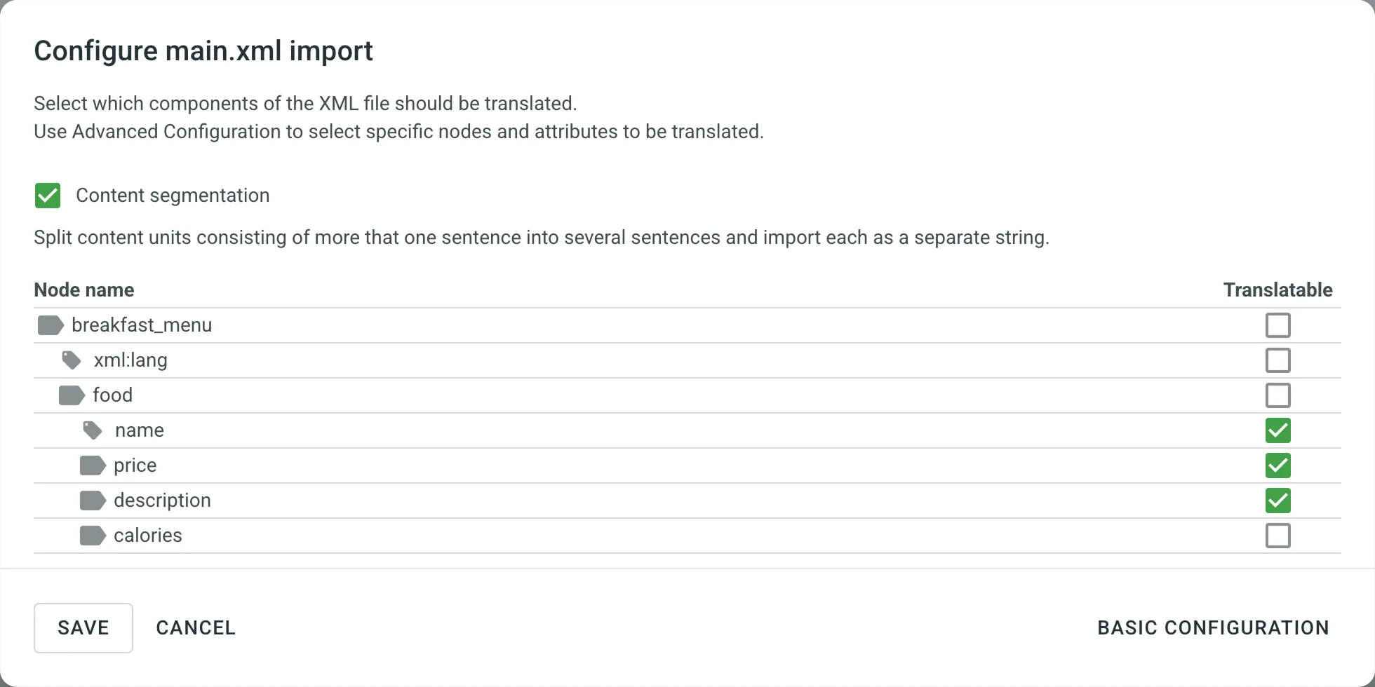

Advanced Configuration
Advanced Configuration allows you to select the specific nodes and specific attributes to be available for translation.
XML Advanced Configuration
The file structure is depicted with the help of icons:
  • Node – Node
  • Attribute – Attribute
