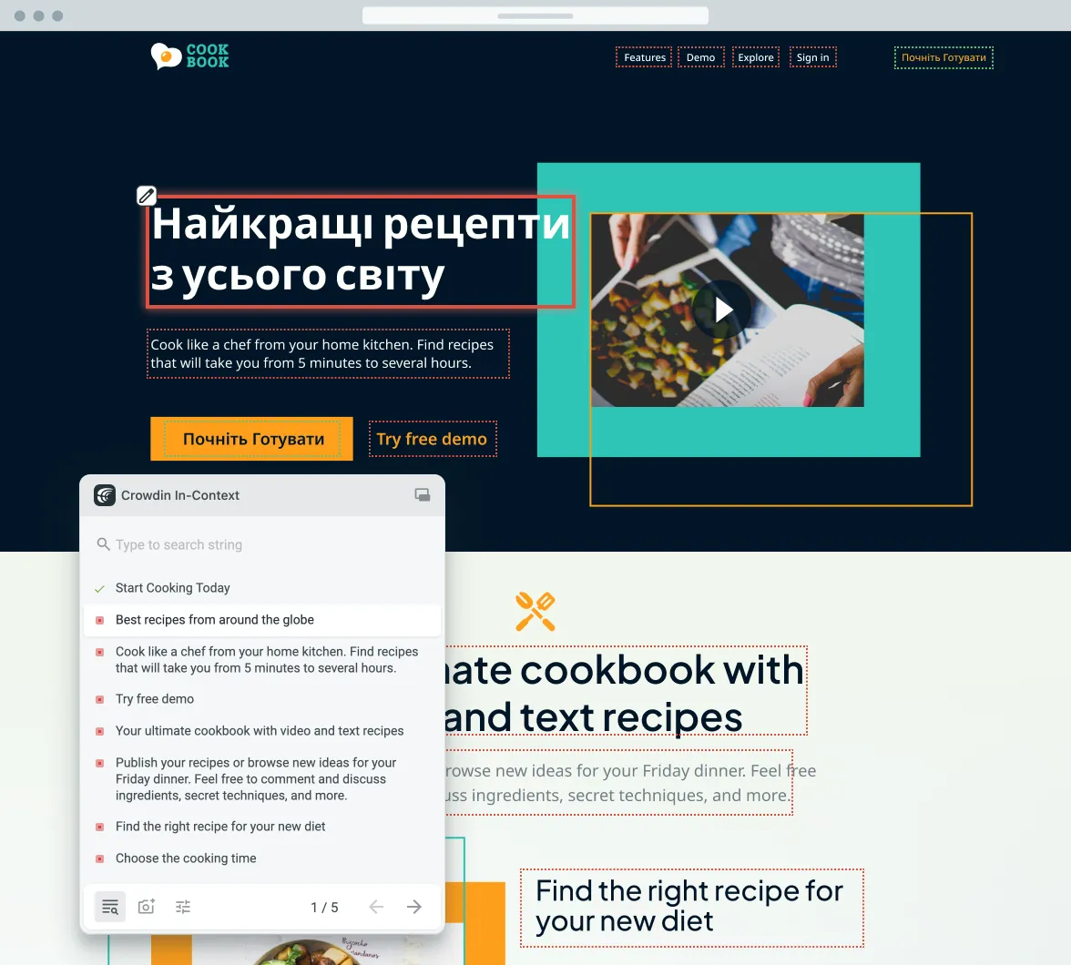

This tool provides a view of your application with editable texts, so the translation process is real-time visible. Even the dynamic part of the application and strings containing placeholders can be translated this way.
Integrated pseudo-language contains special identifiers instead of the original texts. Thus when switching your app to that language, all labels are converted to special identifiers. Javascript searches for those identifiers and replaces them with editable labels. So, the In-context page of your web app will look the same as your application, with the only difference that translatable strings will be editable.
In-Context View
Translations are made directly in the app, with no need to open the Editor. A simplified version of Crowdin Editor will be displayed, with all the functionality (TM, machine translation, approve/vote option, comments, terms) provided. Thus, it’s easier to make and review translations since translators can preview them in a real context.

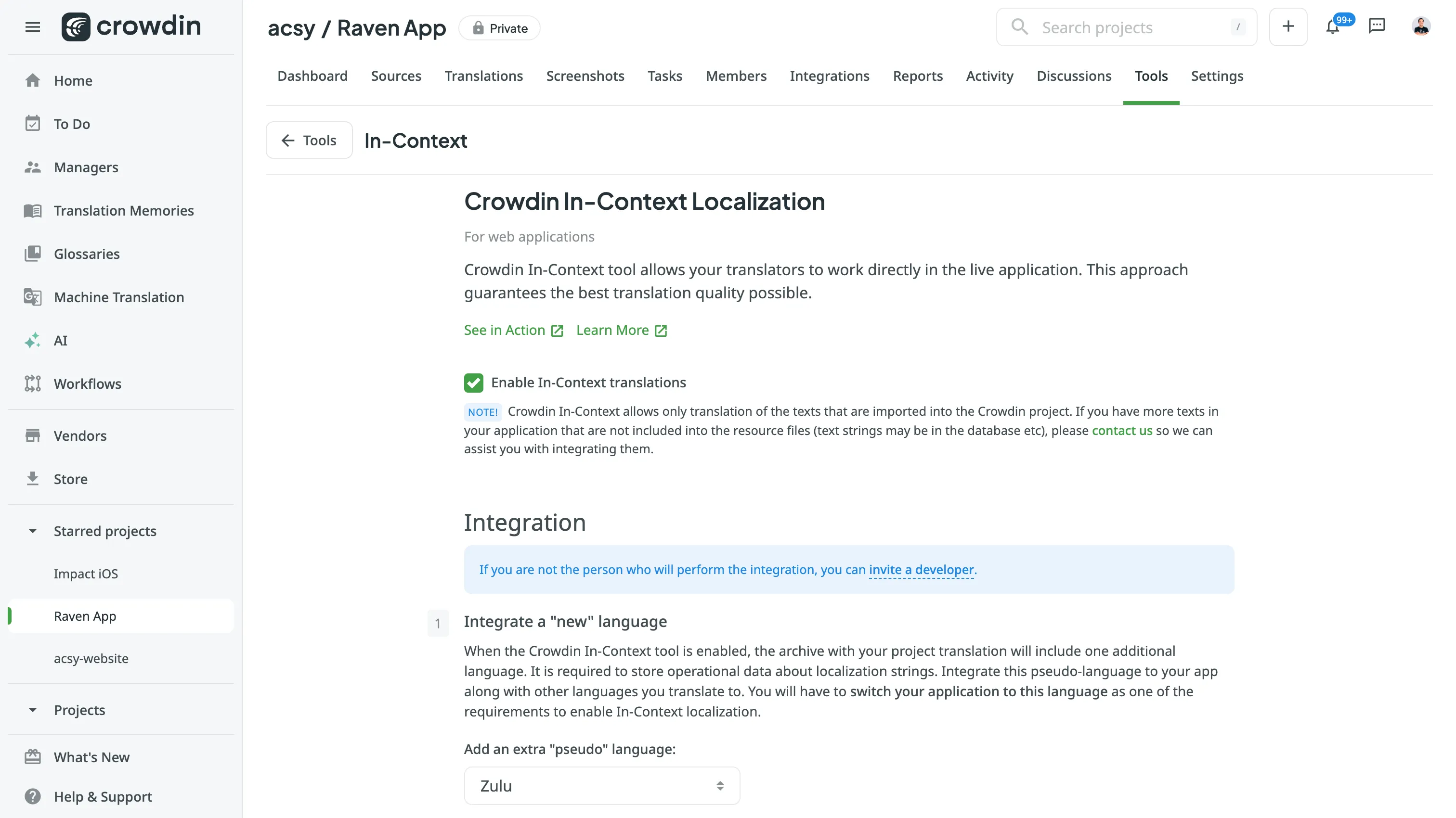

Follow the integration setup guide in your Crowdin project to set up In-Context. The guide can be found in your project, under Tools > In-Context.
In-Context Tab in Crowdin

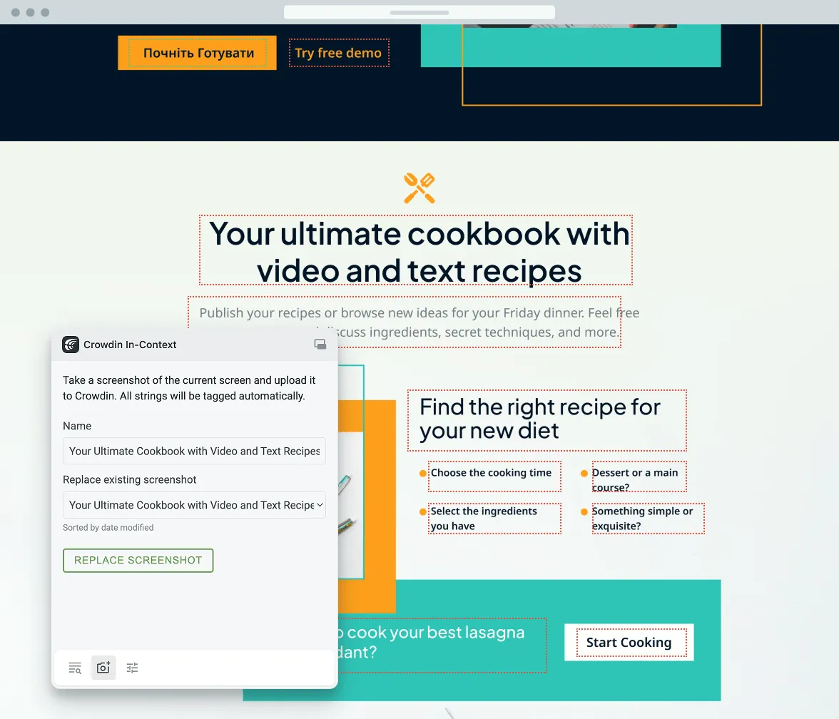

With Crowdin In-Context, you can manage screenshots of your web application pages directly while browsing them. This feature helps you provide up-to-date visual context for translators, ensuring string tagging stays accurate and relevant.
Screenshots taken via In-Context are automatically uploaded to your Crowdin project. All visible strings on the page are tagged automatically, simplifying context management for your translation team.
Read more about Screenshots.
You can take a screenshot of any page of your website while using In-Context and upload it to your Crowdin project. Crowdin will automatically tag all strings displayed on the page in the screenshot.
To add a screenshot via In-Context, follow these steps:
  1. Open your website page with In-Context enabled.
  2. In the Crowdin In-Context dialog, switch to the Screenshot tab.
  3. In the Name field, check the automatically suggested screenshot name based on the page title. Edit it if needed. If no screenshots were previously added for this page, the Replace existing screenshot drop-down will display There is no screenshot with this name.
  4. Click Add Screenshot.
Add Screenshot
Crowdin will upload the screenshot to your project and automatically tag all strings displayed on the page.
You can manually update existing screenshots in your Crowdin project directly from In-Context. This helps keep screenshots and string tags current when your web pages are updated with new content or layout changes.
To update an existing screenshot via In-Context, follow these steps:
  1. Open the updated page of your website with In-Context enabled.
  4. In the Replace existing screenshot drop-down, select the screenshot you want to replace. You can also view the time and date the existing screenshot was added to confirm you’re replacing the correct one.
  5. Click Replace Screenshot.
Replace Screenshot
Crowdin will replace the previous screenshot in your project with the new one and automatically tag all strings displayed on the page.
