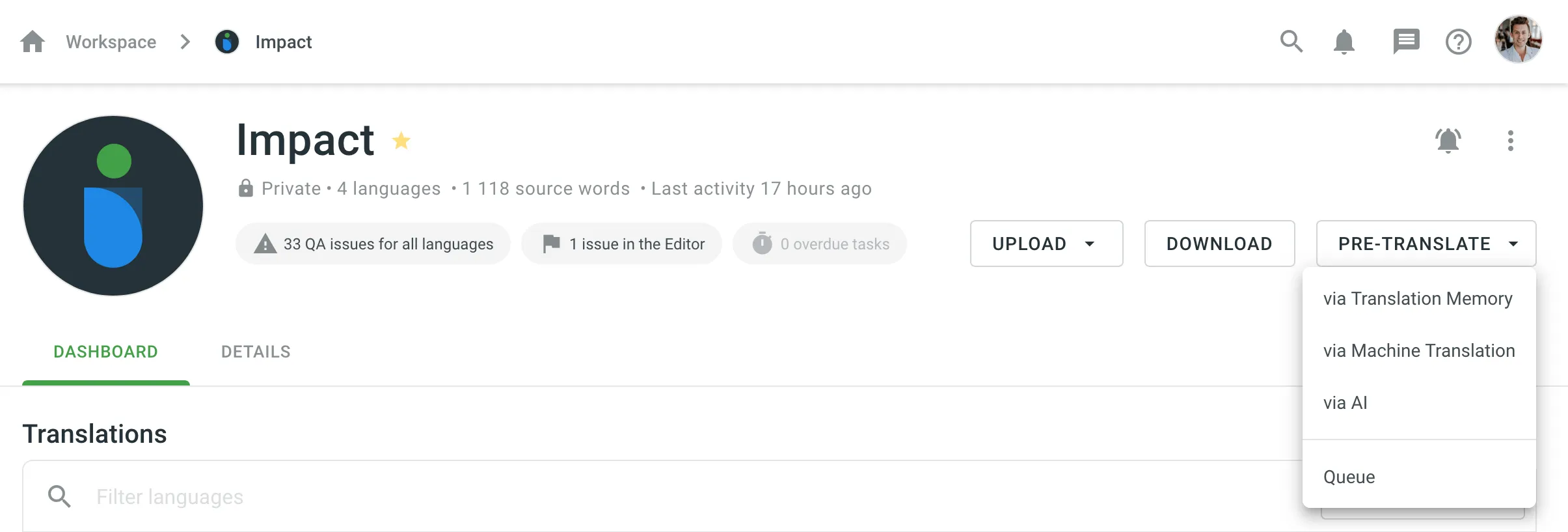

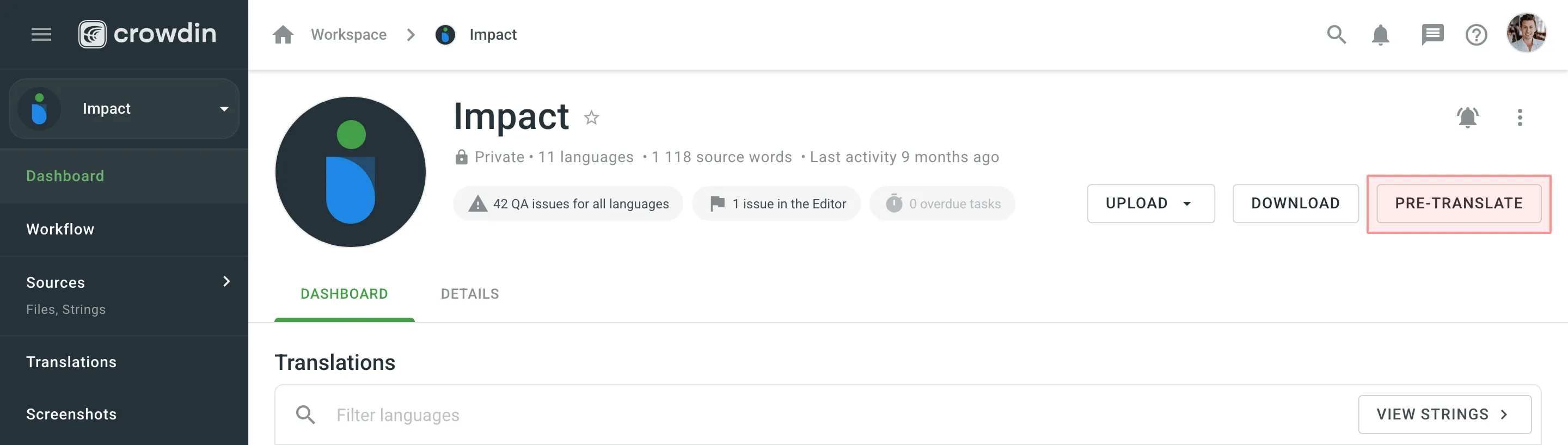

To make pre-translation follow these steps:
  1. Go to the Project home window.
  2. Click Pre-Translate in the top right corner and choose the pre-translation method. Select pre-translation method
  3. Select settings for pre-translation.
    • For TM pre-translate:
      • files for translation
      • target languages
      • pre-translation parameters (minimum match ratio, strings for translation, and approval options)
    • For MT pre-translate:
      • MT engine
      • target languages
      • resulting string status
  4. Click Pre-Translate.
