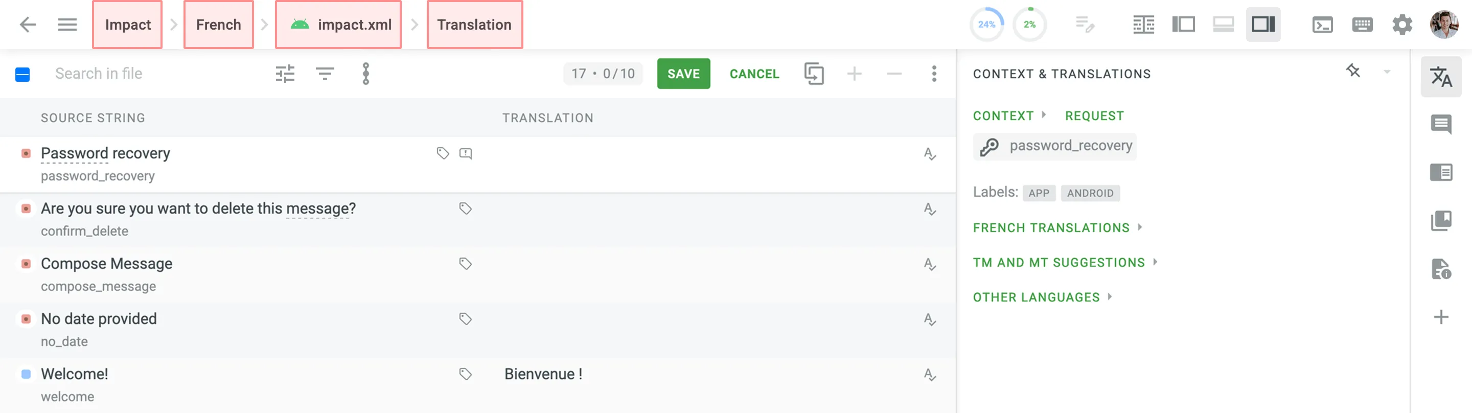

The Editor is the main place in Crowdin Enterprise where project members can work on translations. It allows users to suggest, vote on, review, and approve translations online.
Using the Main menu in the upper-left corner, you can switch between files for translation, change translation languages, contact a manager, change the view, and access help materials.
  • List of strings available for translation, which may vary in different Editor modes.
  • Context, labels, and additional information to guide the work.
  • String search and filtering options for efficient translation management.
  • AI Assistant, Translation Memory (TM) suggestions, and Machine Translation (MT) suggestions.
  • Glossary terms to ensure consistency.
  • Comments section for collaboration and reporting issues.

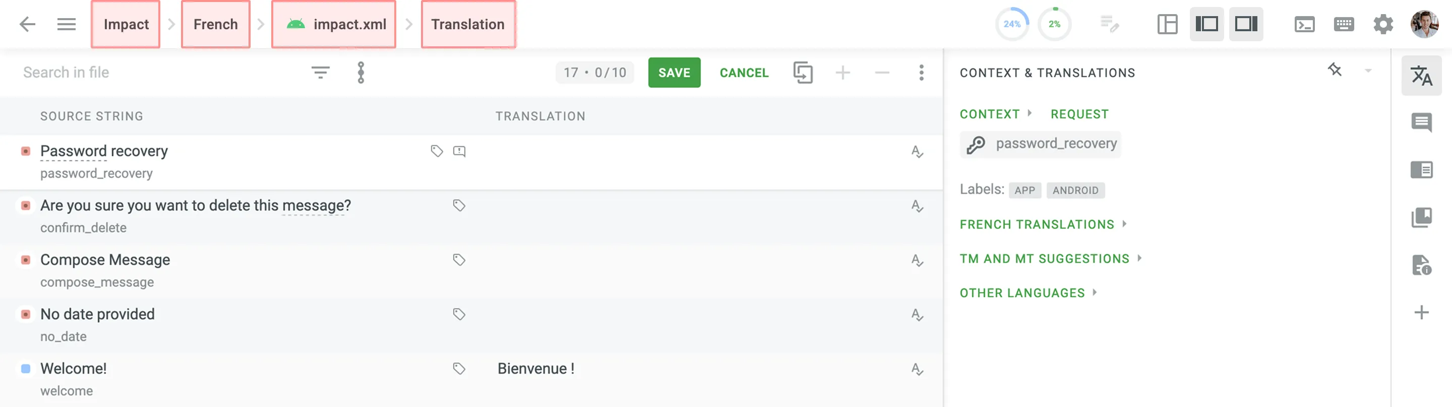

Side-by-side Editor mode
This section displays the list of strings, with the active one highlighted. Strings are text elements that are either individual words, phrases, or sentences. Some strings might have replacement tokens (e.g., 0, 1, %1, etc.) or elements of the ICU message syntax. Such items themselves should not be translated but are used by the website code to dynamically insert some information into strings. To work with such strings, you should copy the source string and translate only the real words.
Strings can have the following statuses:
  • - untranslated
  • - translated
  • - approved
In projects with a workflow, strings can additionally have the following workflow statuses:
  • Todo – Indicates that the string is awaiting action at the current workflow step. For example, on a Translation step, it means the string is untranslated. On a Proofreading step, it means the string is not yet approved.
  • Pending – This status is specific to the Source Text Review step. It indicates that a string has an approved correction with text that differs from the original source text.
  • Done – Indicates that the main action for the current workflow step is complete. For example, on a Translation step, the string has been translated. On a Proofreading step, it has been approved.
There also might be the following icons besides strings:
  • - the string has comments from contributors
  • - the string has an unresolved issue
  • - the string has labels
To suggest a translation, select a string from the list and enter your suggestion in the field next to the original text. When you’re done, click Save. Your suggestion will be added to the string’s translation suggestions list, and you’ll automatically move on to the next string.
Suggesting Translations

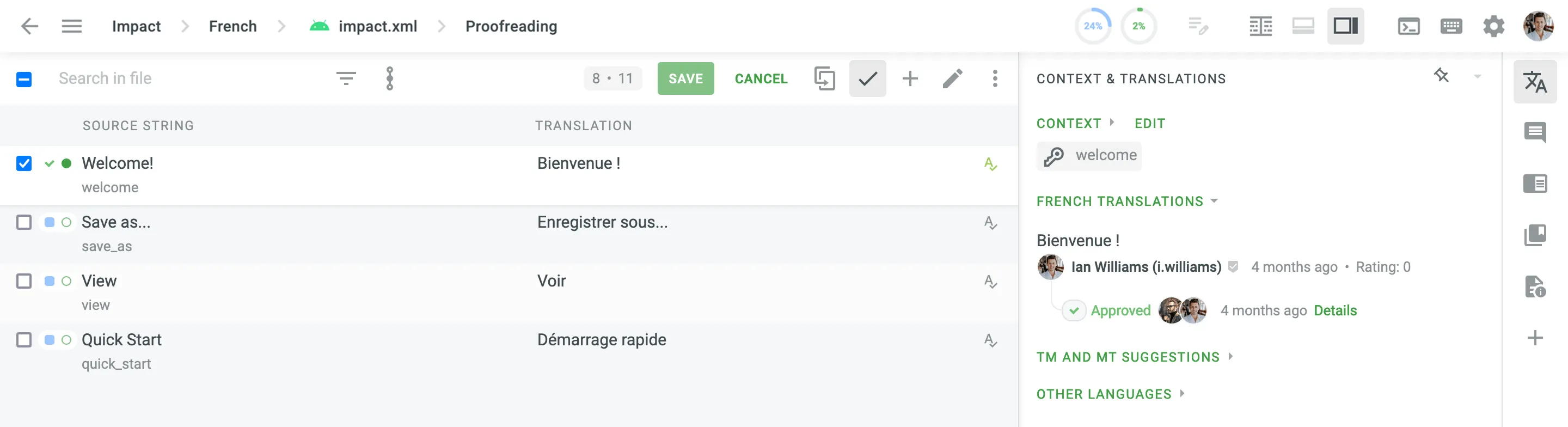

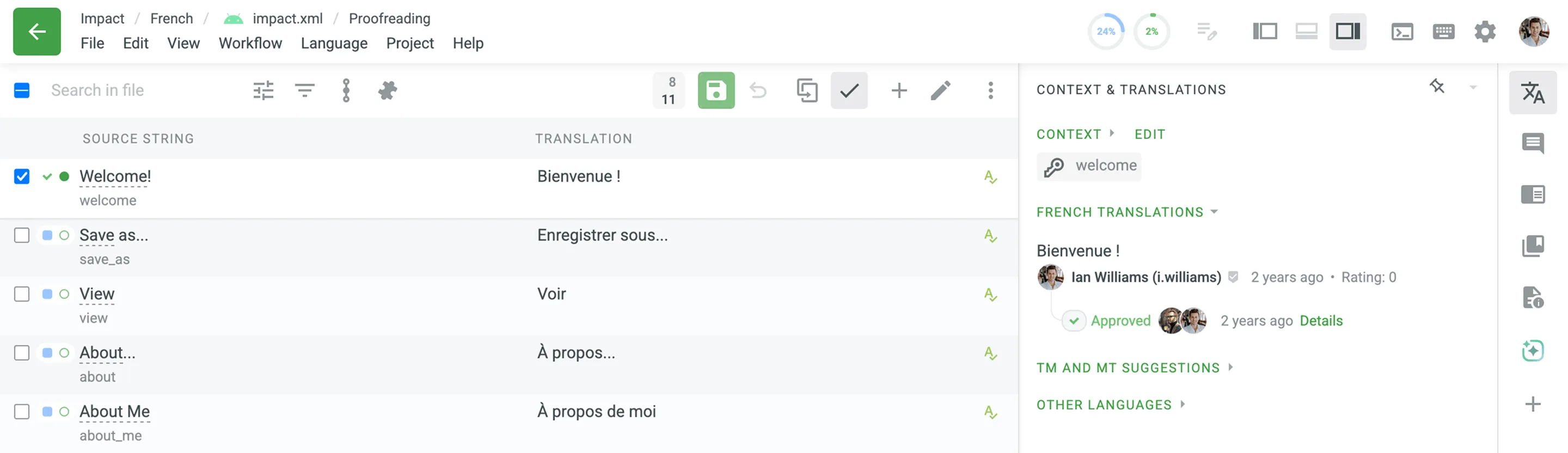

Review the translations to make sure they are ready for export, and click Approve icon next to the suggestion to approve each translation separately.
To approve all or a couple of the strings at once, check the boxes on the left and then click Approve.
Side-by-Side Proofreading QA issues

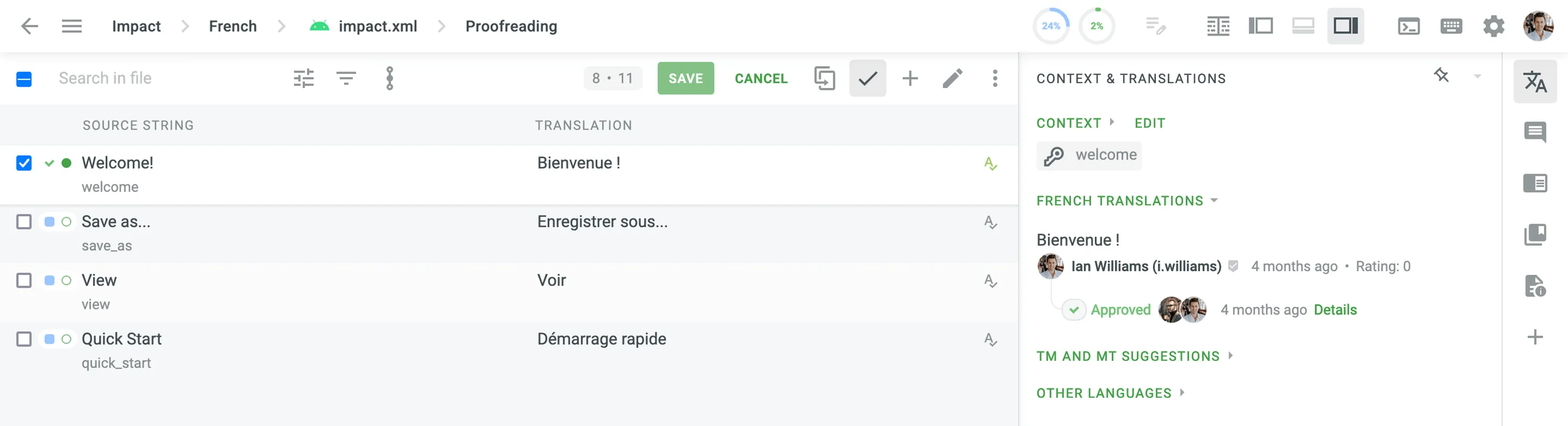

Each translation can be approved either once or multiple times by multiple proofreaders and project members with manager permissions (or higher). Once a translation is approved at least once, it will be displayed as such on all workflow steps of a project.
Multiple Approvals
If necessary, a proofreader or project member with manager permissions (or higher) can edit the list of approvals for translations approved twice and more by removing approvals one by one or all at once.
To edit the list of approvals, follow these steps:
  1. Open the needed string in the Editor.
  2. Click on the profile pictures of the proofreaders that approved a translation.
  3. In the unfolded translation details, click next to the approval you want to remove.
The translations with the highest number of approvals have the highest priority. They will be displayed at the top of the translation list in the Editor and used on translation download.

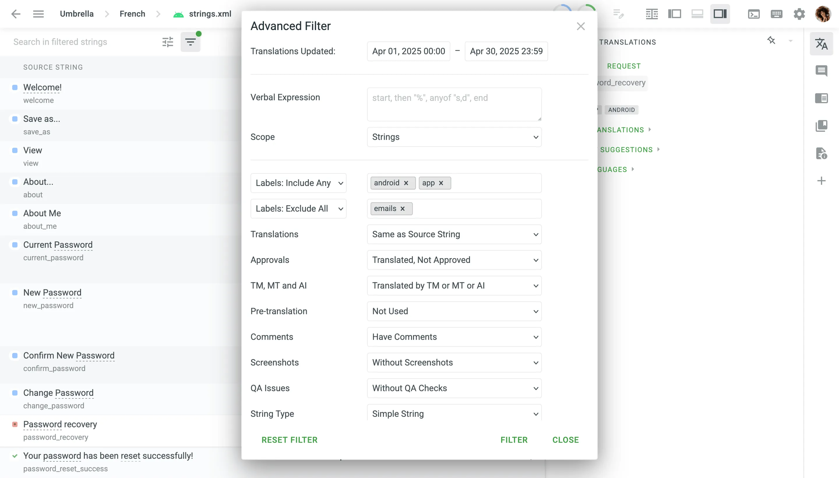

Available filter options:
  • All, Untranslated First – Show all strings from the opened file/folder. Untranslated strings are displayed at the top of the list, followed by translated strings, and then approved ones are displayed at the bottom of the list.
  • QA issues – Show strings with no QA issues or with unresolved QA issues in the current language.
  • Machine Translation – Show strings that are translated by TM or MT suggestions without changes. Often these strings require additional review.
  • Hidden – Show strings that are hidden from translators. Strings can be hidden by project managers or automatically hidden by Crowdin Enterprise when they are marked as duplicates.
Strings Filter

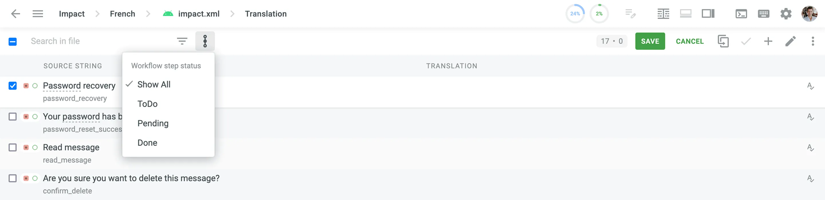

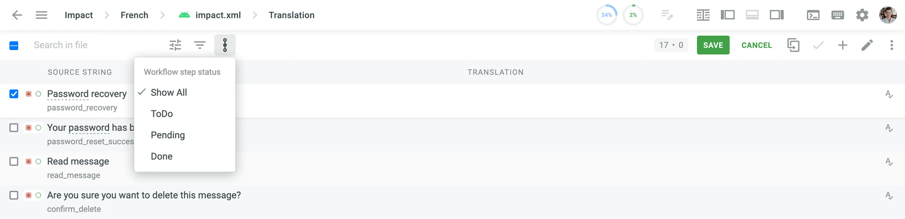

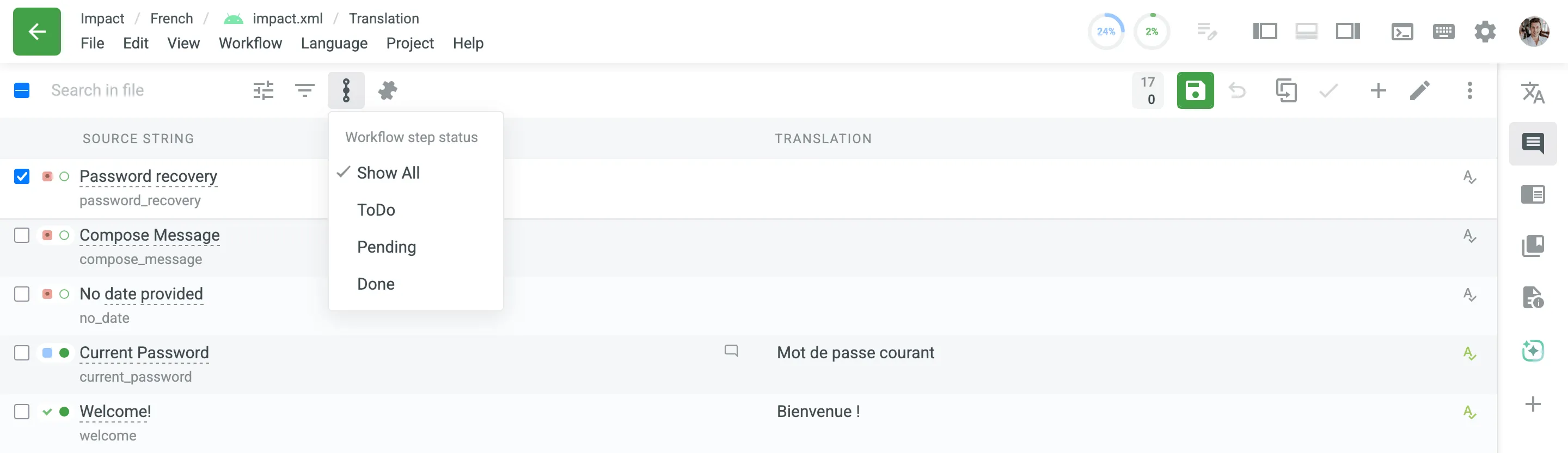

In projects with a workflow, strings move from one workflow step to the next. There are three string statuses: ToDo, Pending, and Done.
Use the icon to view strings with their corresponding workflow step statuses.
Workflow Status filter

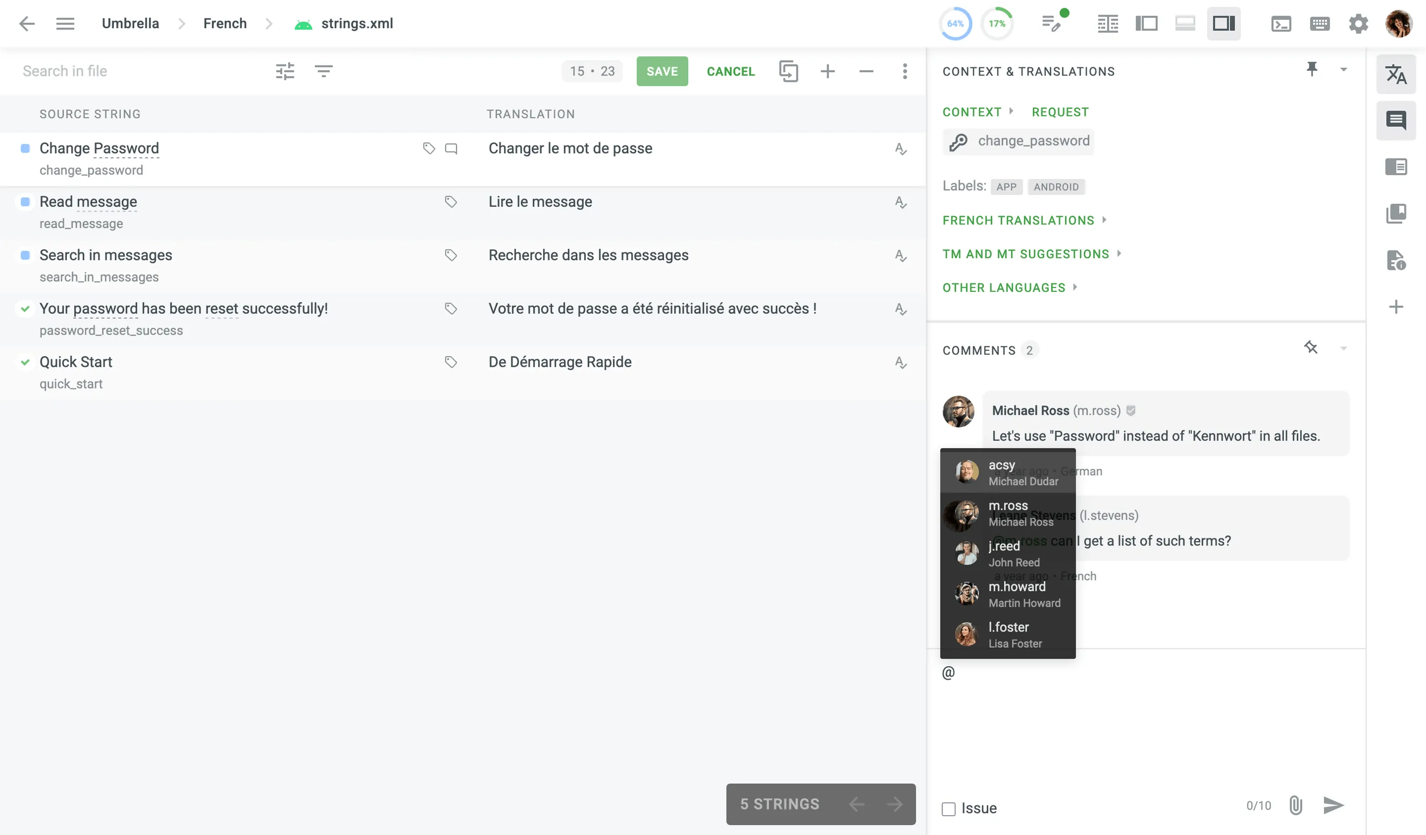

Using the Comments section, you can discuss the meaning of the source string or other related questions. It is recommended to use a source language of the project so other translators can understand it. Use the ”@” character and a username to direct your message to the specific person. You can also mention an entire team assigned to the project by typing ”@” and the team name.
Comment

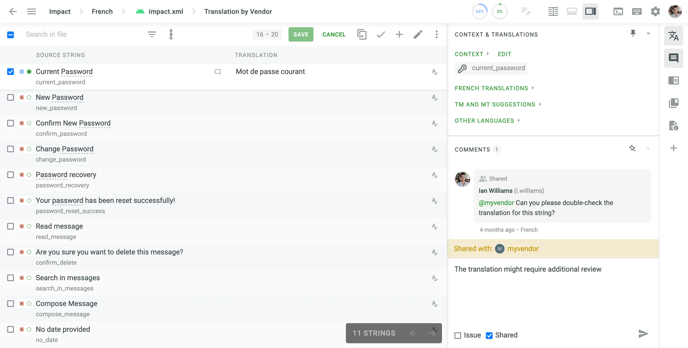

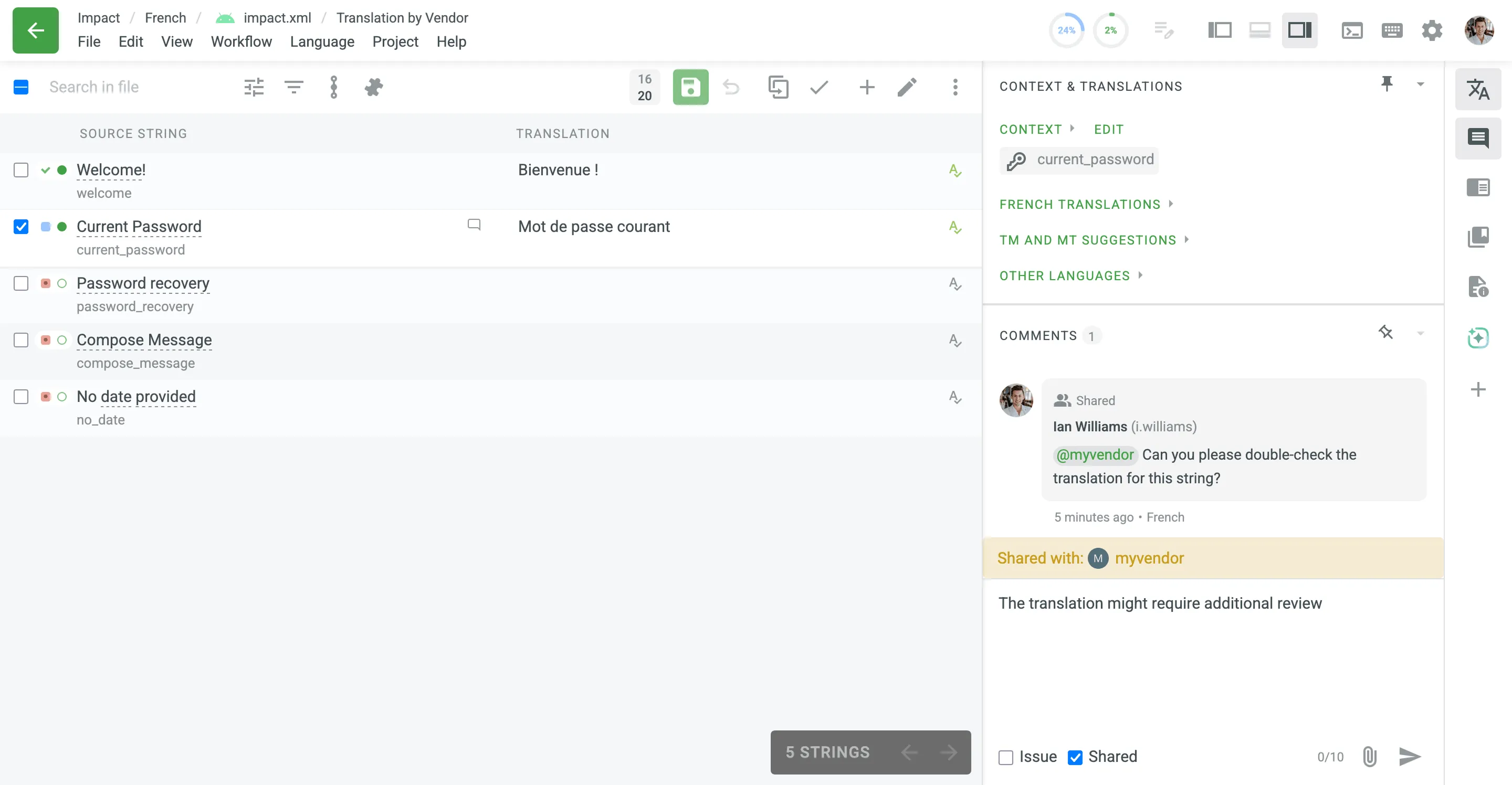

When collaborating with teams from other organizations, such as localization vendors, you can use shared comments to communicate directly within the Editor.
To make a comment visible to all involved organizations, select the Shared checkbox before posting. A notice will appear listing the organizations that will be able to see your comment, ensuring transparency in the discussion.
All comments, both private and shared, appear in a single chronological feed for easy tracking. Shared comments are clearly marked with a Shared label, making them easy to distinguish from internal-only discussions.
To ensure the right people are notified:
  • When you create a shared issue (e.g., reporting a typo in the source text), project managers in all involved organizations will be notified.
  • You can @mention a team (e.g., @YourVendorTeam) to notify all its members. While you can only @mention individual users from your own organization, this allows you to direct questions to the appropriate team.
Any comments created without the Shared option enabled will remain private and visible only to the members of your organization.
Shared Comments

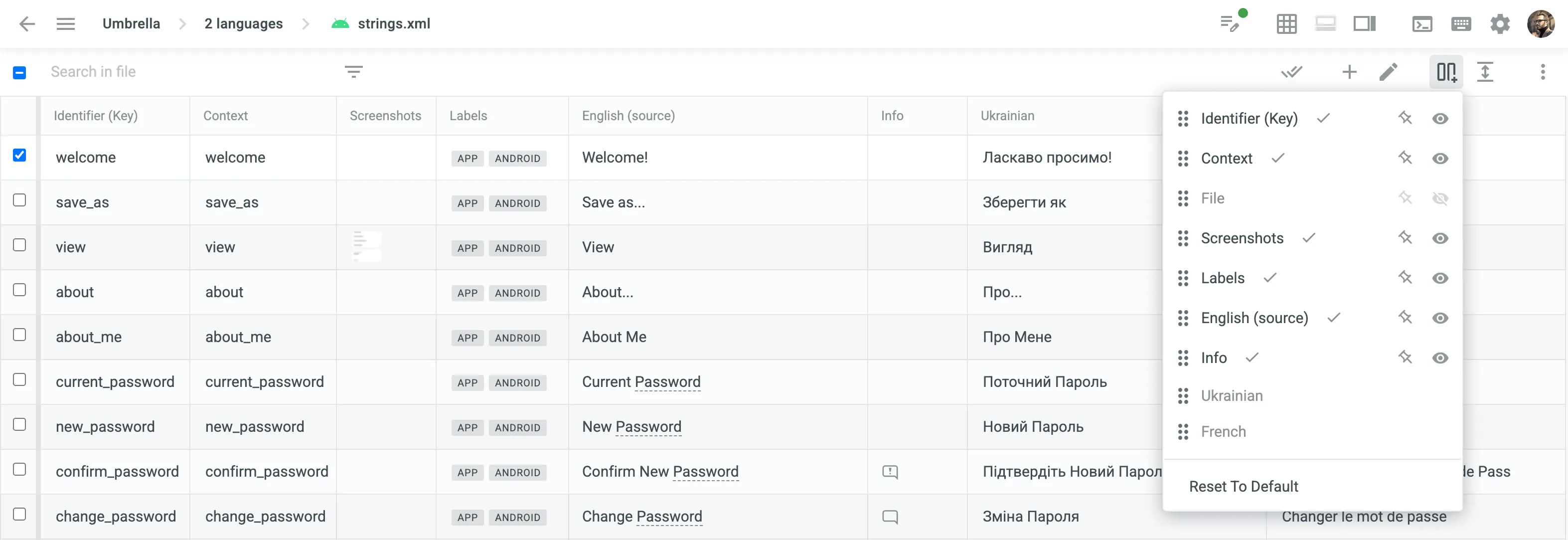

In addition to the multilingual mode, there is a separate Multilingual (Grid) mode. It provides a spreadsheet-like layout where each language is shown in a separate column, allowing you to work with multiple languages in a compact tabular format.
Additionally, to pin or hide individual columns, click the drop-down arrow next to a column title and choose the needed option.
You can also switch between Default View and Compact View using the button in the upper-right corner. The compact option displays more rows by reducing vertical spacing.
Multilingual Mode Grid View

Easy access to most-used menu items in one click:
  • Project – click on the current project name (Impact in the below screenshot)
  • Language – click on the current language (French in the below screenshot)
  • Files – click on the current file name (impact.xml in the below screenshot)
  • Editor Mode (only in projects with a workflow) – click on the current step (Translate in the below screenshot)

You can create a custom filter for strings by clicking the Filter strings icon and choosing Advanced Filter. This feature helps you locate specific strings faster by allowing you to combine multiple filter parameters and define a custom sort order.
Advanced Filter
The filter dialog contains the following parameters, which you can combine to narrow down your search:
  • Strings added – Filter strings that were imported into the project within a specific date range.
  • Strings updated – Filter source strings that were updated within a specific date range.
  • Translations updated – Filter strings where translations were added or updated (including new suggestions, approvals, or votes) within a specific date range.
  • Verbal Expression – Filter strings using complex structural patterns.
  • Labels – Include or exclude strings based on their assigned labels.
  • Translations – Filter by translation status. Options include Untranslated, Partially translated (plurals), Translated, Same as source string, and Modified source strings.
  • Duplicates – Filter strings based on their duplicate status. Options include Master strings, Duplicates only, Duplicates with shared translations, and Duplicates with own translations.
  • TM, MT and AI – Filter strings based on their translation origin. Options include Translated by TM, Translated by MT, Translated by AI, or any combination of the three.
  • Pre-translation – Filter strings based on whether pre-translation was applied. Options include Used or Not used.
  • Comments – Filter strings by comments or issues. You can filter by the presence of comments, unresolved issues, or specific issue types (e.g., Lack of contextual information, Mistake in source string).
  • Screenshots – Filter strings that are With screenshots or Without screenshots.
  • Visibility – Filter strings by their visibility to translators: Visible or Hidden.
  • QA Issues – Filter strings based on quality assurance issues. You can filter for strings with any QA issue, no QA issues, or specific types like Tags mismatch or Spelling mistakes.
  • String Type – Filter by string format. Options include Simple String, Plurals, or ICU.
  • Votes – Filter strings by the net number of votes. Options are Greater Than or Less Than a specified number.
  • Translated by – Filter for strings translated (or not translated) by a specific project member.
The Advanced Filter also supports Verbal Expressions, which allow you to find strings that match specific structural patterns, such as the placement of variables, formatting, or punctuation, rather than matching exact text.
  • Verbal Expression – Enter the pattern you want to search for.
  • Scope – Define where to search for the pattern. Options include Strings, Context, Translations, Identifier (Key), or Everything.
For a quick way to filter by a single label, you can click on any label tag displayed in a string’s context area. Hovering over a label will display a tooltip that reads Filter by label: {label-name}. Clicking the label instantly applies the Advanced Filter with that specific label selected and the Labels: Include Any rule. All other filter parameters are cleared. If you then click a different label, it will replace the previous one in the filter.
For more complex queries involving multiple labels, you can set rules to include or exclude strings:
  • Labels: Include All / Labels: Include Any – use this drop-down menu to choose the logic for including labels. Then, add the desired labels in the corresponding field.
    • Include All: includes only strings that have all of the selected labels (AND logic).
    • Include Any: includes strings that have at least one of the selected labels (OR logic).
  • Labels: Exclude All / Labels: Exclude Any – use this drop-down menu to choose the logic for excluding labels. Then, add the desired labels in the corresponding field.
    • Exclude All: excludes only strings that have all of the selected labels (AND logic).
    • Exclude Any: excludes strings that have at least one of the selected labels (OR logic).
This allows you to narrow or expand the filtered results depending on your needs.
  • Include example – to find strings tagged with both ui and button, select Labels: Include All and add those two labels.
  • Exclude example – to exclude all strings tagged either marketing or deprecated, select Labels: Exclude Any and add those two labels.
  • Sort by – Organize the filtered strings based on a selected criterion. The available options are:
    • Original sort order
    • Strings added (by date)
    • Translations updated (by date)
    • Last comment added (by date)
    • Alphabet (Source Text)
    • Alphabet (Identifier)
    • Length (of the source string)
    • Votes
  • You can also set the sort order to Ascending or Descending.

Once a translator or proofreader has a task assigned, all the task details are accessible from the editor:
The name of the task is displayed at the top of the toolbar.
Task name
Task details can be accessed by clicking the menu in the upper-left corner.
The task menu consists of the following components and features:
  • name, due date, language, type of the task, and assignee
  • options to download and upload translations for the particular task
  • possibility to quit the particular task editor and show all project strings
  • Replace in Translations option
  • Replace in Sources option
Task menu
