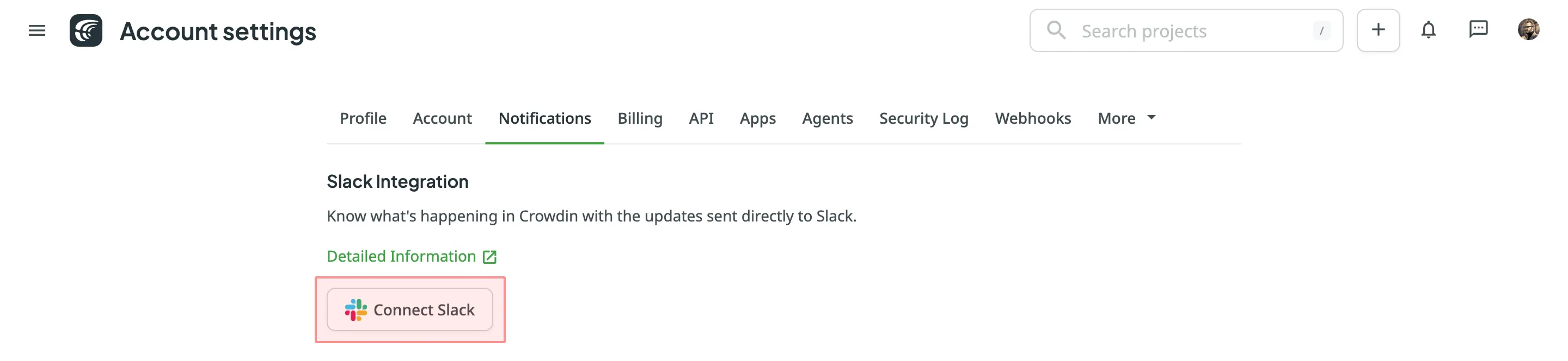

To receive Crowdin notifications via Slack, follow these steps:
- Click on your profile picture in the upper-right corner and select Settings.
- Switch to the Notifications tab and click Connect Slack.

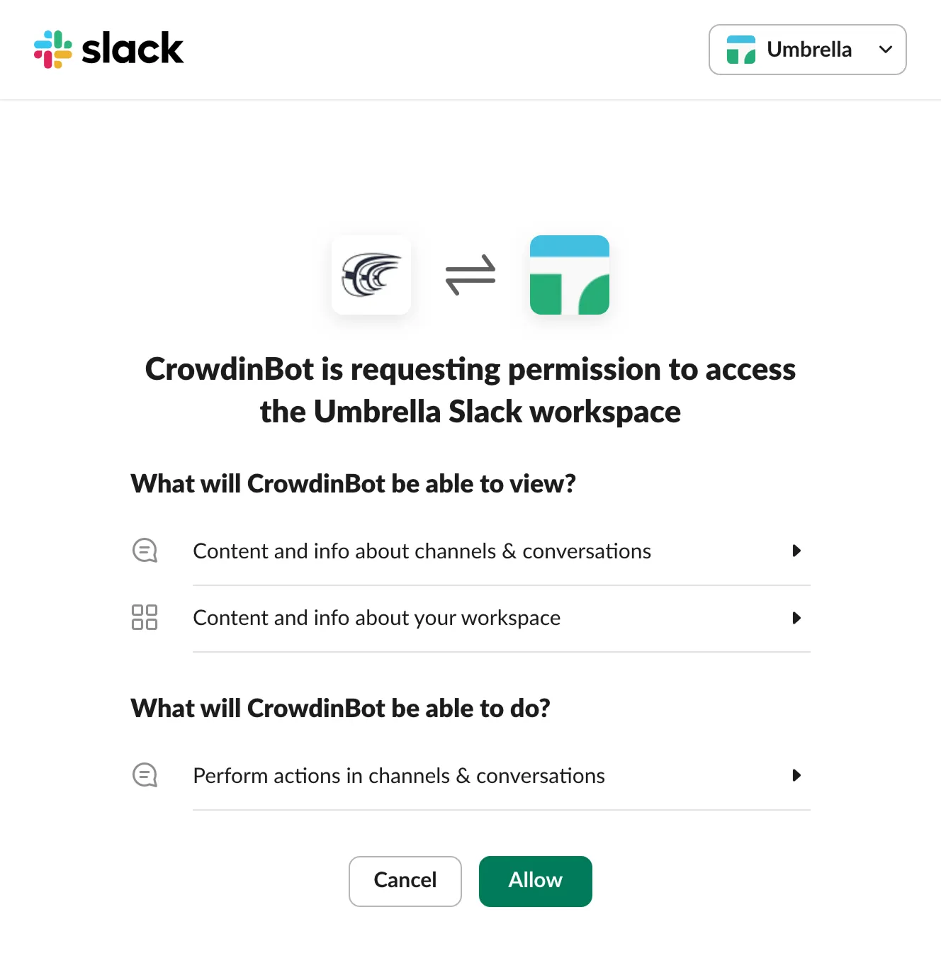

- Authorize the connection with Crowdin on the Slack side.
- Go back to Crowdin and select the notifications you want to receive in Slack.

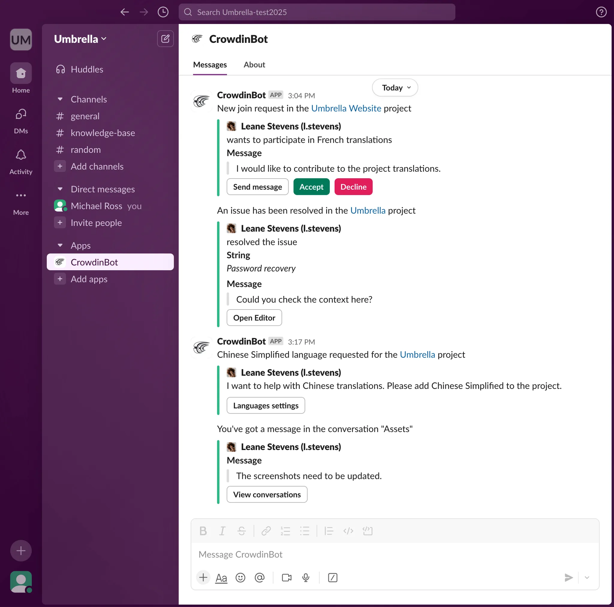

You will receive the selected types of notifications as direct messages from the Crowdin bot.

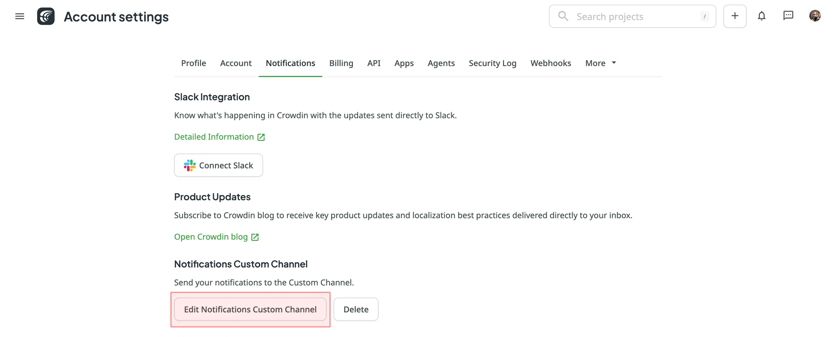

Configuring
To configure custom notifications in Crowdin, follow these steps:
- Open your Account Settings and go to the Notifications tab.
- In the Notifications Custom Channel section, click Set Up Notifications Custom Channel to start configuring your custom notifications.

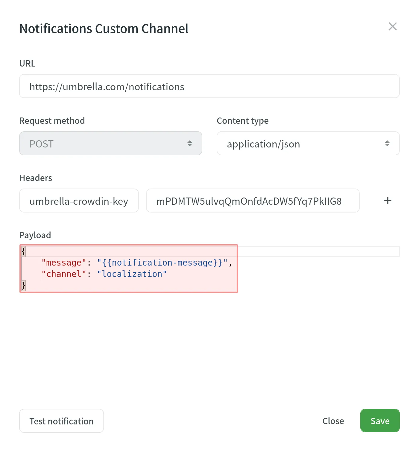

You will need to provide the following information to set up custom notifications:
- The URL where the callback should be sent.
- The content type for the POST request method (
multipart/form-data
,application/json
, orapplication/x-www-form-urlencoded
Optionally, you can add special headers to your custom notifications. They can be used for additional security, as an authorization method, and more. For example, if you add headers, your custom notification endpoint can verify them and ensure that information is coming from Crowdin.
When configuring custom notifications, click Test notification to see how your application will react to that call. Once finished with the configuration, click Save.
Depending on your approach to custom notification management, you might need to add dedicated Crowdin IP addresses to your firewall to allow Crowdin to open the pre-configured custom notification URLs.
Read more about IP Addresses.
Custom Payloads
You can modify the custom notification payload to add and organize the elements as your system requires. To get informative and user-friendly notifications, make sure to include the {{notification-message}}
placeholder in your payload.
