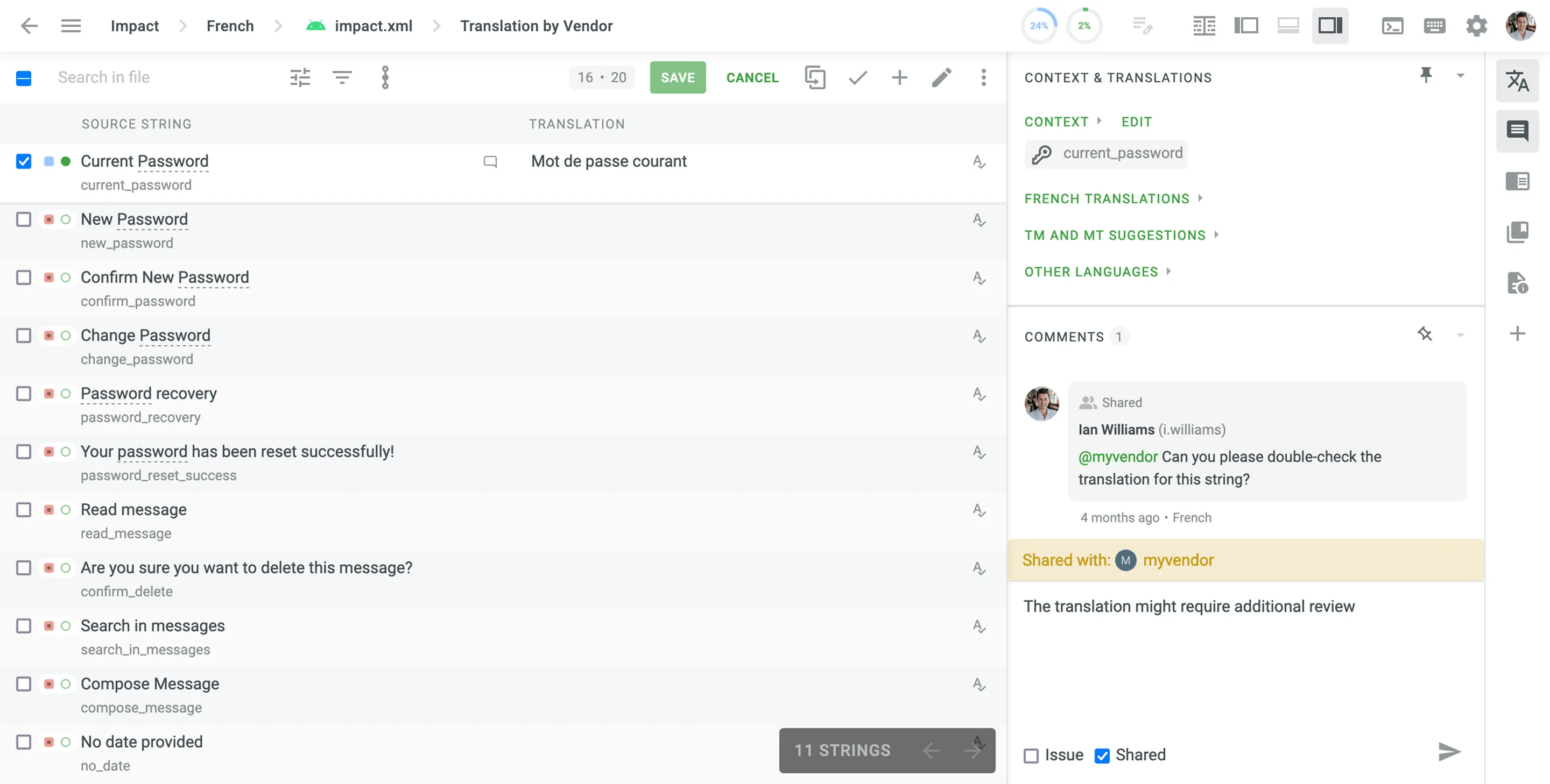

Side-by-side Editor mode
This section displays the list of strings, with the active one highlighted. Strings are text elements that are either individual words, phrases, or sentences. Some strings might have replacement tokens (e.g., 0, 1, %1, etc.) or elements of the ICU message syntax. Such items themselves should not be translated but are used by the website code to dynamically insert some information into strings. To work with such strings, you should copy the source string and translate only the real words.
Strings can have the following statuses:
  • - untranslated
  • - translated
  • - approved
In projects with a workflow, strings can additionally have the following workflow statuses:
  • Todo – Indicates that the string is awaiting action at the current workflow step. For example, on a Translation step, it means the string is untranslated. On a Proofreading step, it means the string is not yet approved.
  • Pending – This status is specific to the Source Text Review step. It indicates that a string has an approved correction with text that differs from the original source text.
  • Done – Indicates that the main action for the current workflow step is complete. For example, on a Translation step, the string has been translated. On a Proofreading step, it has been approved.
Besides the status icons, strings can also display the following markers:
MarkerAppears whenClick action
LabelsThe string has labels.Opens the Context & Translations panel with the string’s labels.
CommentsThe string has comments and no unresolved issues.Opens the comment dialog.
Comments with IssuesThe string has unresolved issues.Opens the comment dialog.
ScreenshotsThe string has screenshots attached.Opens the Context & Translations panel and the first screenshot in the screenshot viewer.
Master StringThe string is the original string for one or more duplicates.Opens the duplicates list in a new tab.
Duplicate StringThe string is a duplicate of another string.Opens the original string in a new tab.

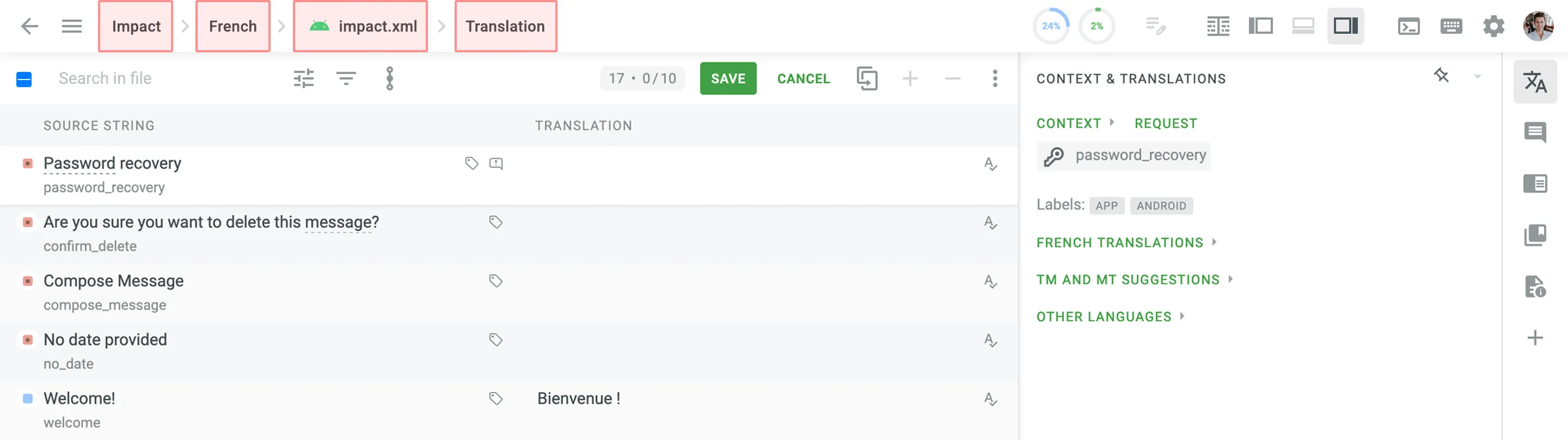

To suggest a translation, select a string from the list and enter your suggestion in the field next to the original text.
To streamline the translation process, you can enable the Auto-save feature. When the Auto-save translations setting is enabled in the Editor Settings, your translations are automatically saved when you switch to another string. A “Saving…” indicator will appear briefly, followed by a “Saved” confirmation.
By default, Auto-save is disabled, meaning you need to manually click Save translation for each string. When Auto-save is disabled, the Save translation button acts as the primary action and appears green. When Auto-save is enabled, the button becomes gray, as manual saving is optional.
Once saved, your suggestion will be added to the string’s translation suggestions list. By default, the Automatically move to next string option is enabled, so the Editor will then move to the next string.
If you need to discard your current input and revert to the previous state before saving, click Cancel.

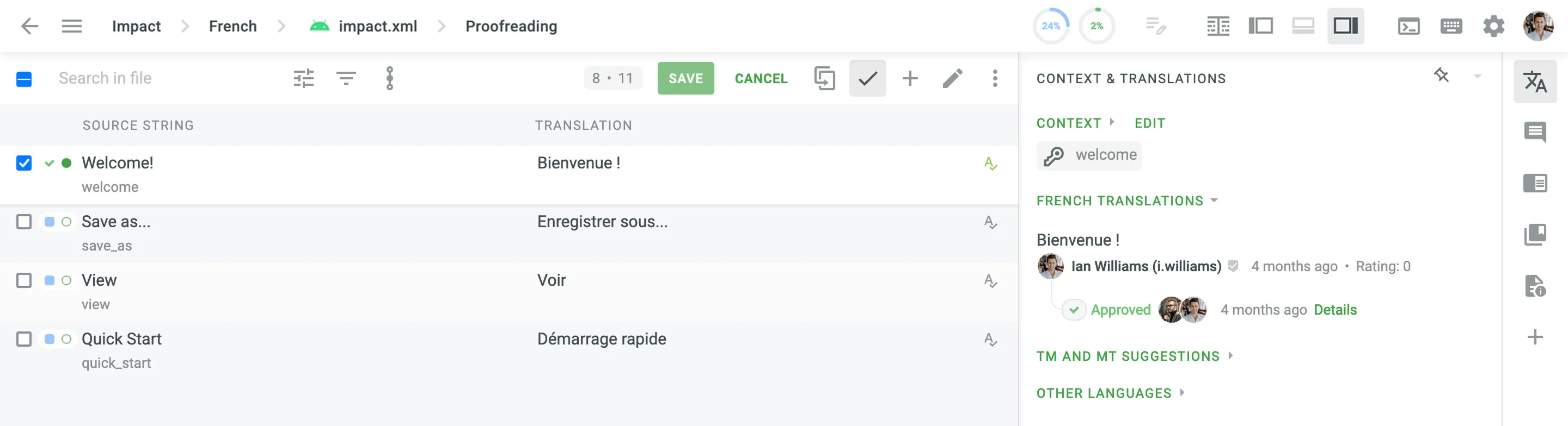

Review the translations to make sure they are ready for export, and click Approve icon next to the suggestion to approve each translation separately.
To approve all or a couple of the strings at once, check the boxes on the left and then click Approve.
Side-by-Side Proofreading QA issues
Each translation can be approved either once or multiple times by multiple proofreaders and project members with manager permissions (or higher). Once a translation is approved at least once, it will be displayed as such on all workflow steps of a project.
Multiple Approvals
If necessary, a proofreader or project member with manager permissions (or higher) can edit the list of approvals for translations approved twice and more by removing approvals one by one or all at once.
To edit the list of approvals, follow these steps:
  1. Open the needed string in the Editor.
  2. Click on the profile pictures of the proofreaders that approved a translation.
  3. In the unfolded translation details, click next to the approval you want to remove.
The translations with the highest number of approvals have the highest priority. They will be displayed at the top of the translation list in the Editor and used on translation download.
When a string has more than one translation, the translation list is formed based on the following priority:
  1. Translation with the highest number of approvals – Among translations approved multiple times, the translation with the highest number of approvals has a top priority.
  2. Translation with the last added approval – Among translations approved only once, the translation with the last added approval has a top priority.
  3. Most voted translation – Among translations that don’t have approvals, the translation with the highest number of votes has a top priority.
  4. Last added translation – Among translations that don’t have approvals or votes, the last added translation has a top priority.

If you see that there is already a correct translation, vote for it by clicking the plus sign if you like the translation, or the minus sign if you don’t think the translation is correct. Translations that receive the most positive votes will have a higher rating and will appear at the top of all available translations for the string.
Vote

Comment
When collaborating with teams from other organizations, such as localization vendors, you can use shared comments to communicate directly within the Editor.
To make a comment visible to all involved organizations, select the Shared checkbox before posting. A notice will appear listing the organizations that will be able to see your comment, ensuring transparency in the discussion.
All comments, both private and shared, appear in a single chronological feed for easy tracking. Shared comments are clearly marked with a Shared label, making them easy to distinguish from internal-only discussions.
To ensure the right people are notified:
  • When you create a shared issue (e.g., reporting a typo in the source text), project managers in all involved organizations will be notified.
  • You can @mention a team (e.g., @YourVendorTeam) to notify all its members. While you can only @mention individual users from your own organization, this allows you to direct questions to the appropriate team.
Any comments created without the Shared option enabled will remain private and visible only to the members of your organization.
Shared Comments

The proofreading process works mainly the same way as in side-by-side mode, except when approving or removing approvals for all or a couple of strings at once, the system performs the action for all languages selected for the multilingual mode.

The navigation path in the upper-left corner of the Editor displays your current context within the workspace, offering quick access to file statistics, task information, and project navigation. Its behavior depends on whether the Horizontal Menu is enabled in your Editor Settings.
When the Horizontal Menu is enabled (default):
The path serves as a visual indicator of your location (project name, target language, file name, or workflow step (only in projects with a workflow)) and provides quick-reference information on hover:
  • File Statistics – Hovering over the file name opens a popover displaying the translation and approval progress (word counts and percentages) for that specific file.
  • Task Details – When you open a task in the Editor, the task title appears in the path alongside its corresponding task type icon. Hovering over the task title reveals a popover with additional details, including a direct clickable link to the task (opens in a new tab), the target language, and the task type.
When the Horizontal Menu is disabled:
You can click the individual items in the navigation path to open their respective dropdown menus:
  • Project – Click the current project name to access project-level options.
  • Language – Click the current language to switch to another target language.
  • File – Click the current file name to open the File menu.
  • Detailed Progress Breakdown – Hover over the file name in the top navigation path to view a popover with information on the total word count, number of translated, auto-translated, and approved words, along with the percentage completion for each. (If the Horizontal Menu is disabled, this breakdown is located in the Main menu > File).

Once a translator or proofreader has a task assigned, all the task details are accessible from the Editor.
The name of the task is displayed in the navigation path in the upper-left corner. Hovering over the task name reveals a popover with additional details, including the task ID, a direct link to the task, due date, the target language, the task type, and the assignee.
Task name
When working on a task, the standard File menu is replaced by the Task menu. You can access it by clicking Task in the main menu. It contains the following options:
  • File and string navigation options (Open, All Strings, File Previews)
  • Options to Export and Upload translations for the particular task
  • Project Strings – select this option to quit the particular task editor and show all project strings.
